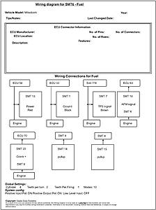

I didn't see the SMT6 wiring diagram in the download section for the 4g69 piggy on perfectpower.com. It looks like you'll need to sniff it out.

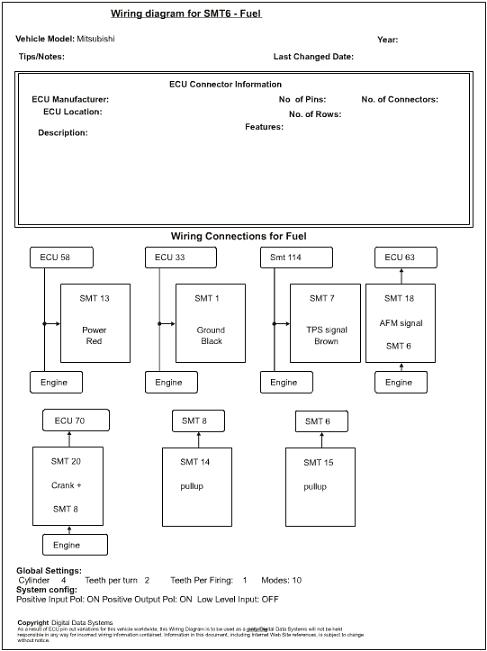

I sent the diagrams to a couple of guys who PM'd me but here it is I will attach it to this thread. along with the email the guys from perfect power sent me.

I sent the ECU layout along with all the info from our cars and this was the result .
[ATTACH]SMT6[/ATTACH]
Note to all of you I've already installed this piggy and was working flawlessly I sold it to a guy in PR cause I was traveling to the US and was planning on using the Emanage ultimate but then decided to go back to the smt6. This box is almost the same concept as the one that comes in the RRM TURBO kit. It can advance and retard timing adjust fuel , and also you can adjust CLOSED LOOP . It has a lot of outputs to set up if you want additional injectors , NOS control and shift lights etc.
