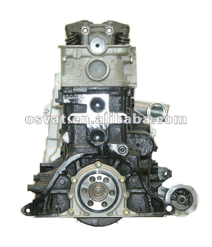

You can see the rear of the crank shaft here in the bottom right. Where the flywheel connects, if that seal around the shaft goes bad it could appear to be coming from the oil pan.

Yes, the oil pan touches the rear main seal housing...so if it was leaking between the block and the housing, then it would look like the oil pan was leaking...this is what the rear of the block looks like with no transmission/flywheel/clutch...
