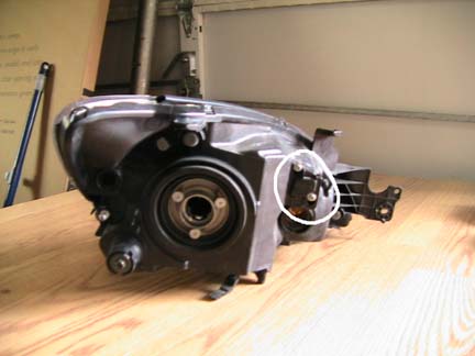

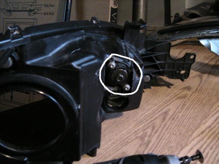

one question for u, how do u do the horizontal aiming through our headlights? i know that the vertical aiming is through a screw in the back of the headlights. but, where is the horizontal aiming screw? can't see to find it. so, if u or anyone else else knows, please let me know.
i thought about making a harness, but i didn't trusted myself with that project. so, i order one insted through auto-lighting online from the UK. their harness works like a charm...simple plug and play. and they are run through the battery with each ballast having it's oown wire harness. so, if one blows up..i still have another light running. as oppose to two ballasts connecting to one wire.
I had to dremel off the cover to the Horizontal aiming screw. There are 2 security bolts or something holding it on.
i knew i took pics of these for a reason!
Be very careful that you dont over tighten the screw. i did and it broke the place that holds it at the reflector. but JBWELD fixed that for me. i love that stuff

yeah...found out about the horizon screw a few minutes ago..hehehhe
