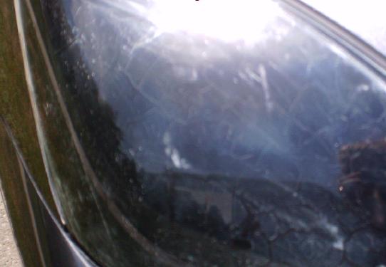

you guys im a dumba$$... i need help!
ok, i wanted to re-do my headlights b/c they were too dark and I wanted to make them lighter. Well, turns out, this niteshade tinting spray sh-t wouldnt come off. Now my headlight is cracked, "spidered", and ruined. I tried using goof off, paint thinner, but not anything w/ acetone.... my headlight is ruined... i dont think I can use anything to get it off... or is there?
does anyone know what would remove this off the headlight?
should i just purchase new ones from the dealer?
should I check e-bay?
anyone have a set to sell?
or should I check a junk yard?
HELP

Well if the lense is the only part is ruined, I think you can just buy that piece instead. If not you might to look around like in eBay or here in EvoM.

for the time being you could prolly use a very light grit sandpaper along w/ water and slowly wetsand that paint off. hopefully your light wont get damaged but it may be too late... i was gonna say nail polish remover but i think that has acetone (Sp?)

This would be your best bet. 1500+ grit and wetsand the sh*t off...I mean, the light's already messed anyways, right?

Do what Azure said and wet sand it, then go with even finer grits, 2000, 4000. You ever seen that Flitz stuff on tv? It's a polish that works on plastic. Try any kind of plastic polish with a buffer and it should be ok. you might need to start with rougher than 1500 grit though, that doesnt take paint off very well. Maybe 800 to start.

ill pm evodave and see if he has anextra set... if not, i will try the nail polish remover, if that doesnt work, then ill do the sandpaper.
my lights arent ruined, its just the headlight plastic lens.

Trust me, new showcar paiutn finishes are wetsanded, so it won't do any damage...just use a really light abbraision paper.
