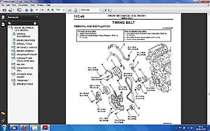

Hey guys, lookin to do my timing belt in the next week or so, was wondering if anyone had a link to a how to guide or knew the torque specs for the tensioner an bolts. Tried searching but I'm using my phone an it's not to friendly

Here.

You are a hero
