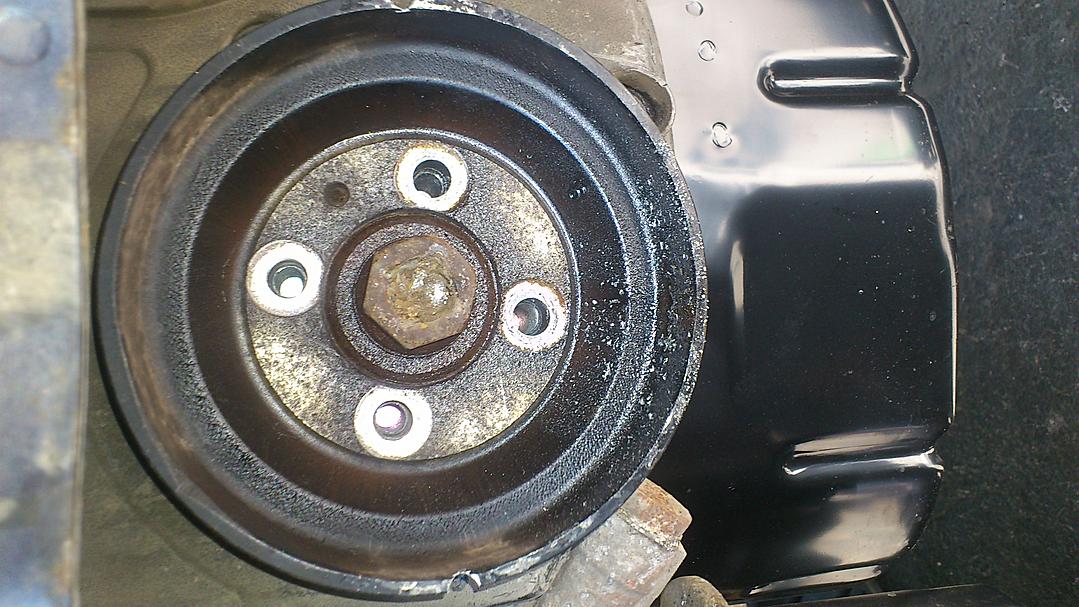

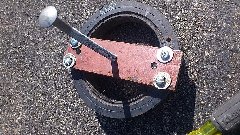

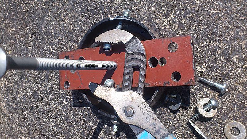

So I'm working on my '05 Ralliart attempting to install the RRM underdrive pulley. All was going according to plan until it came time to remove the stock pulley. I removed the 4 bolts as per the instructions and began my work. By hand, not a chance. Tap around it with a hammer maybe shake it loose, nope. Spray in some wd-40 multiple times, rig up a ghetto puller and try, nope. First attempt with the puller I drilled and tapped two 1/4"-20 holes into the stock pulley. The 1/4"-20 bolt stripped the pulley hole threads and ripped out of the pulley when loaded. So I tried 4 bolts (you can see what I mean in the puller pic) and again not a freakin' millimeter would this damn pulley move.
I searched the forums and the only issues I see ppl having are with the tensioner (which I found very easy to do by myself..) but nobody mentioning that the pulley removal was a problem. What gives? How'd you guys that have done this mod get the pulley off? Please help my car is dead until I finish this as I'm sure I can no longer use the stock pulley after what I've done to it.

if it's already fubar, just smash it with a hammer, you won't hurt the crank...just don't miss, LOL!

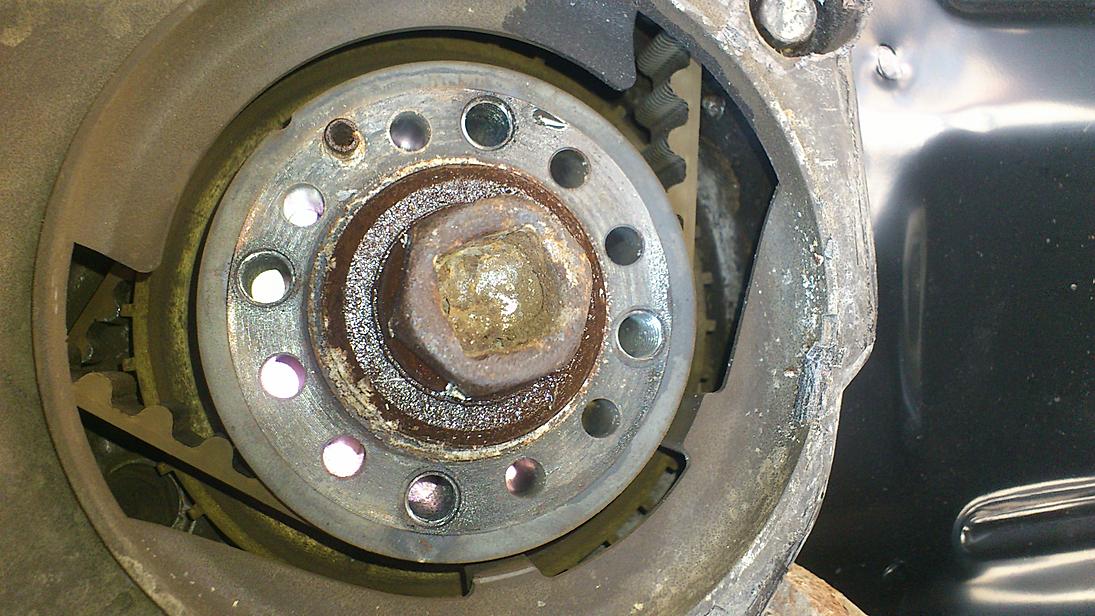

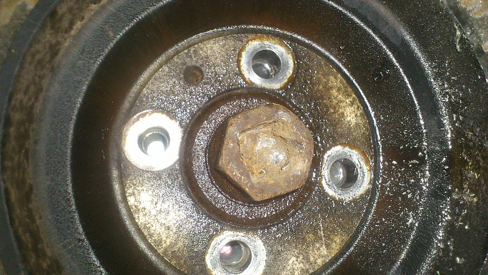

So the outer part of the pulley came off just now, but the inner remains firmly attached. I cannot swing a hammer at this. I hope the UDP is worth the headache here.

use PB Blaster on that should take care of it

PB blaster. Wd-40 is more of a rust, and adhesive removal.

lol, hammer a chisel between the pulley and the crank maybe?? i dunno that's ****ed...

a cheap gear puller is what I'd try next. If not, heat the pulley with a torch, that will expand it and break the rusted connection for sure.

Alright so I used a mini-torch lighter to heat it up as best I could and came up with a puller solution. Drilled it out sideways to stick a bolt through that the puller plate could catch on and it worked! Got the UDP install wrapped up and then proceeded with installing the piggyback ECU which was a breeze just double checking to make sure all wires are connected properly then popped in the timing box and called it a day. Let it idle 30 min and took it out for a gentle 30 min drive all is running well.
