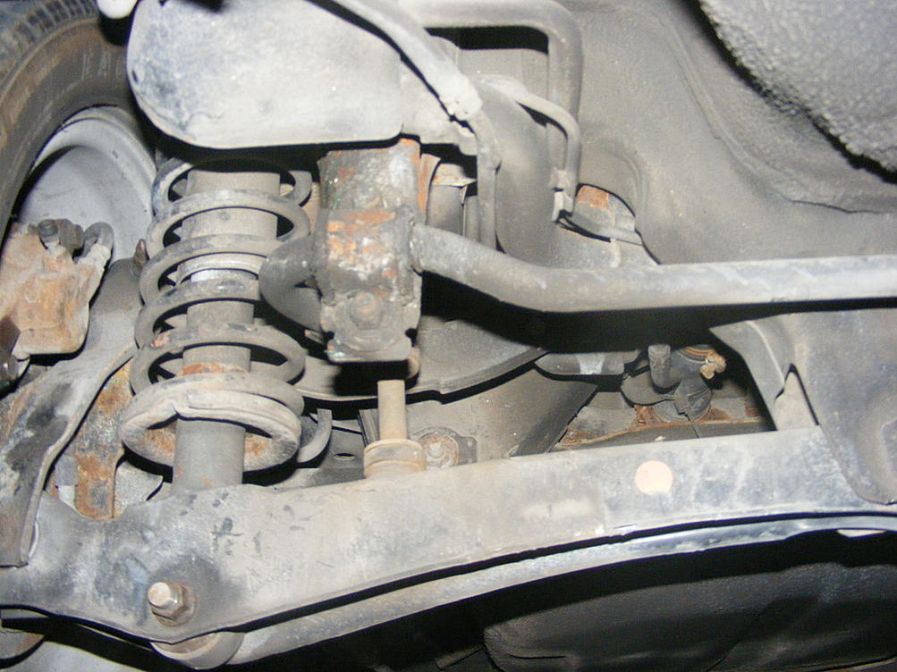

I am wondering what these bolts are for and what might cause them to back out?
TIA
Pictured is the rear suspension. The bolts go into the rear floor pan or prehaps the suspension mount area, I'm unsure.

Hint: Where is your rear anti sway bar ?
Those bolts hold it used to hold it rather to the body. You should see similar holes on the right side too.
Then in the bottom arms, near to where the bottom of the shock mounts, there are holes or should be holes for the links that connect the anti sway bar to the suspension.
Not the end of the world that it 's not there but as you have on Teins, I suspect handling matters to you so get that bar connected, well find it first.

You showed me yours, so I'll show you mine.

That's exactly what you are seeing in the picture sir.
Progress from RRM, mounts and all.
If you just want a stock bar and perches pm me, but you have Teins, Progress would be the way to go.

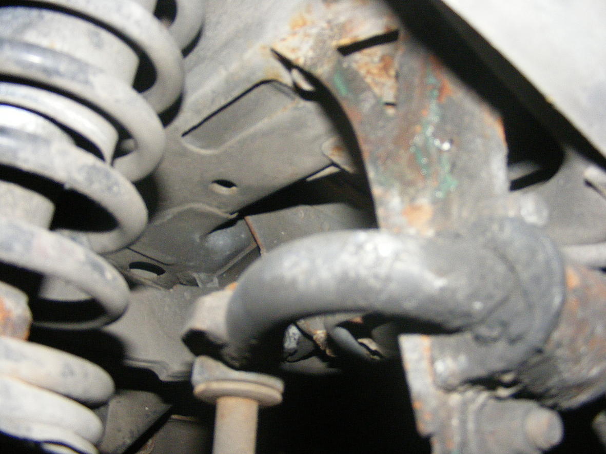

Here is the other pic, I couldn't get multiple pics attached.

No the anti sway bar will not impact your suspension geometry, it just does a fantastic job of restricting body roll, enhancing turn in and general cornering and making the driver feel good.
The strut brace should just be keeping the top in place, not pulling, just reinforcing so that the chassis cannot flex and the suspension can do its job.

I was trying to convince myself that the Sportback didn't have a rear anti-sway bar, then I found this on the passenger side...
