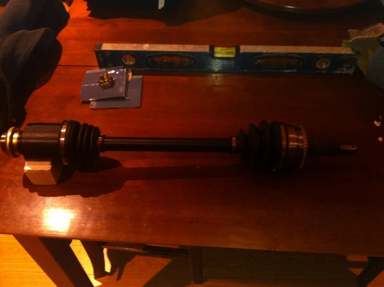

Yeah man I know what your saying. Every time I save money to do something, something else always comes up that's more important. Finally decided to put in on the credit card and deal with it later..... As for my freaking AXLE!!!!
Some guy in the market place was selling RA parts it said selling 04-06 RA parts.
I ordered the axle he had for sale got it yesterday I tried to put it in today and the spindle is to big!!!! I don't get it mabey the 04 model is different than the 05-06 with the direction any idea???? I finally gave up and ordered one from my local part store!!!!! Finally the cars going good took about 2 hours. Should be getting the rest of my parts this week probs gona get my timing belt done at a shop and then I can go on a nice spiritual drive!!!!

can you upload a picture of the axle assembly, and spline count?

Wow didn't even realize but just found a Part# its MR580504 I think its for the EVO!

so now we know...EVO axles just dont fit...lol

If this is infact and EVO axle no it does not fit...

what doesn't fit? that's only half the axle assembly...does the outer spline not fit in the hub? you can just swap it with the lancer outer...the actual shafts i know have a different spline where they meet the CV joints, but i was under the impression the actual splines for the diff and hub were the same...

it's possible but if you're gonna go thru all the trouble...you should've just bought the boot kit in the 1st place...
makes no sense to buy a new axle and swap out an old worn out section just to make it fit...
if i went and bought the whole axle insetad of the boot kit and it didint fit, personally, i'd rather go thru the hassle of returning it for the right one instead of swapping over the old end section to make it fit
No the spline does not fit in the hub it is a lot thicker then the stock one. I didn't measure it but I would say it is almost a half size bigger. My stock spline was jammed I had to get it out with a torch.
Just found this thread from 2009
Originally Posted by BCspeed34
Great parts list, but I have a few questions to ask about this conversion.
1. Are the backing plates what the rear calipers mount to? If not, what part do they mount to?
YES.
2. If I wanted to use Evo knuckles in the front (to use Brembos) what parts would I need to mount them, if they are not strictly bolt-on?
I don't know. Theoretically the Evo spindle should bolt on. However, the Evo has a completely different bearing assembly from the Lancer/Ralliart. So if the spline count/size on the Evo's outer CV is different from the Lancer/Ralliart you won't be able to use it.
3. Are the Evo wheel bearings different than the Lancer? Would using Evo knuckles require bearings and hubs from the Ralliart?
Evo bearings are completely different from the Lancer/Ralliart bearings.
