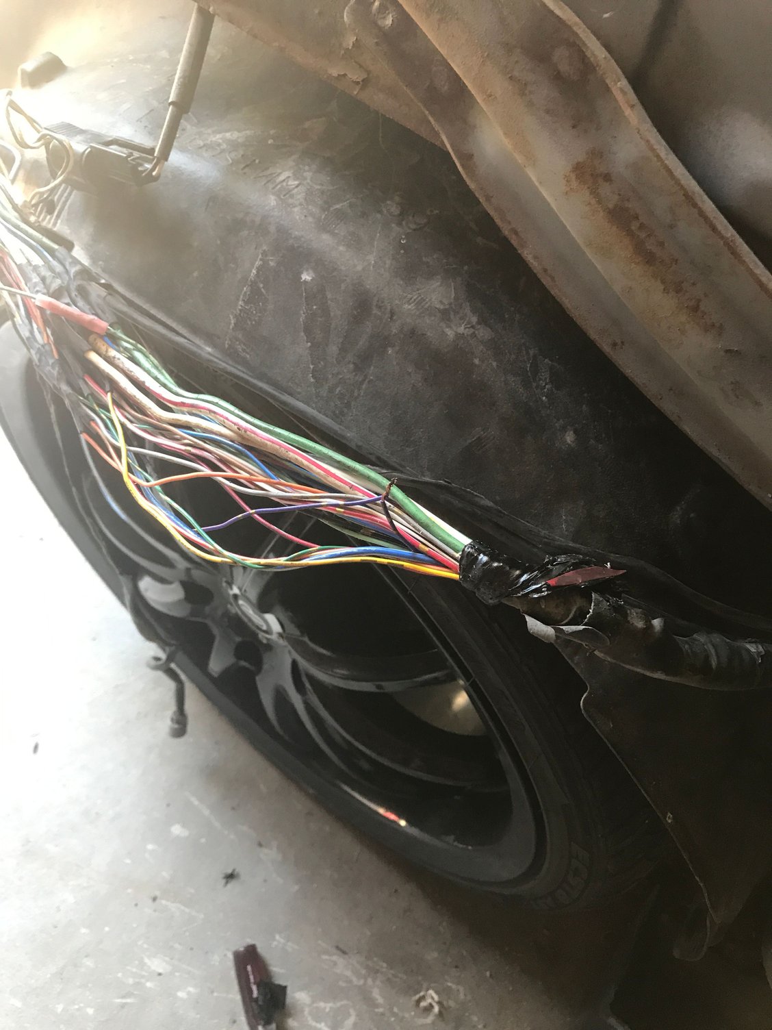

did you take it in to replace the wire or did you do that yourself and if you did do that yourself was there any solder required or did you have to unplug a bunch of stuff to get to the wire, how labor heavy was that fix?
I just took fender off and carefully checked each wire. It was the smallest bit of corrosion on the purple wire. The wires in that area were wrapped very well so don’t know how it happened but I just used the heat shrink with solder from Amazon. Hope that helps.
