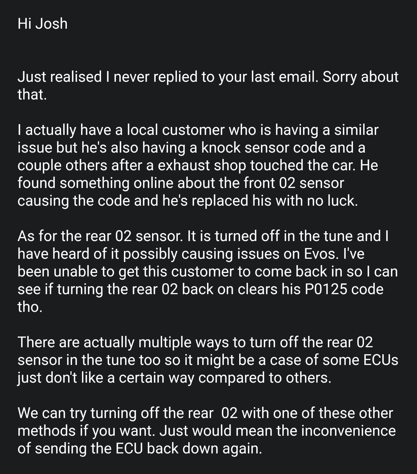

My tuner has emailed me back saying the rear o2 sensor has been turned off and has also faced the same problem on another car as well. I need a tactrix so i can disable the imobiliser on my spare ecu so i can atleast still get to work lol or send my spare ecu to another place I know get immobiliser disabled and when it gets back than send my current ecu back to my tuner and keep my car on the road as I need to get to work
In writing about o2 sensor

my tuner disabled my rear o2 sensor which was causing it. He since disabled it a different way and is now all good. Had nothing to do with my cooling system or wiring 😅
