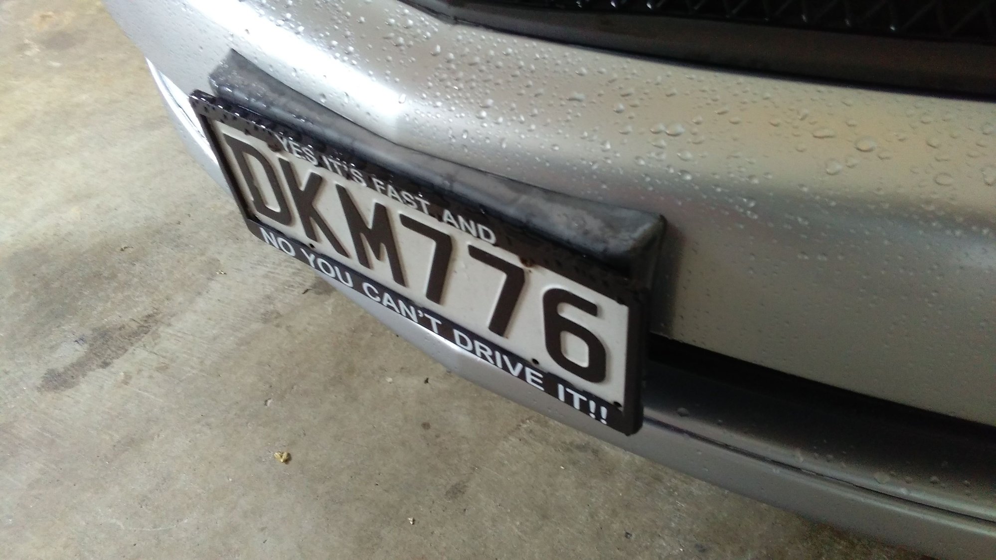

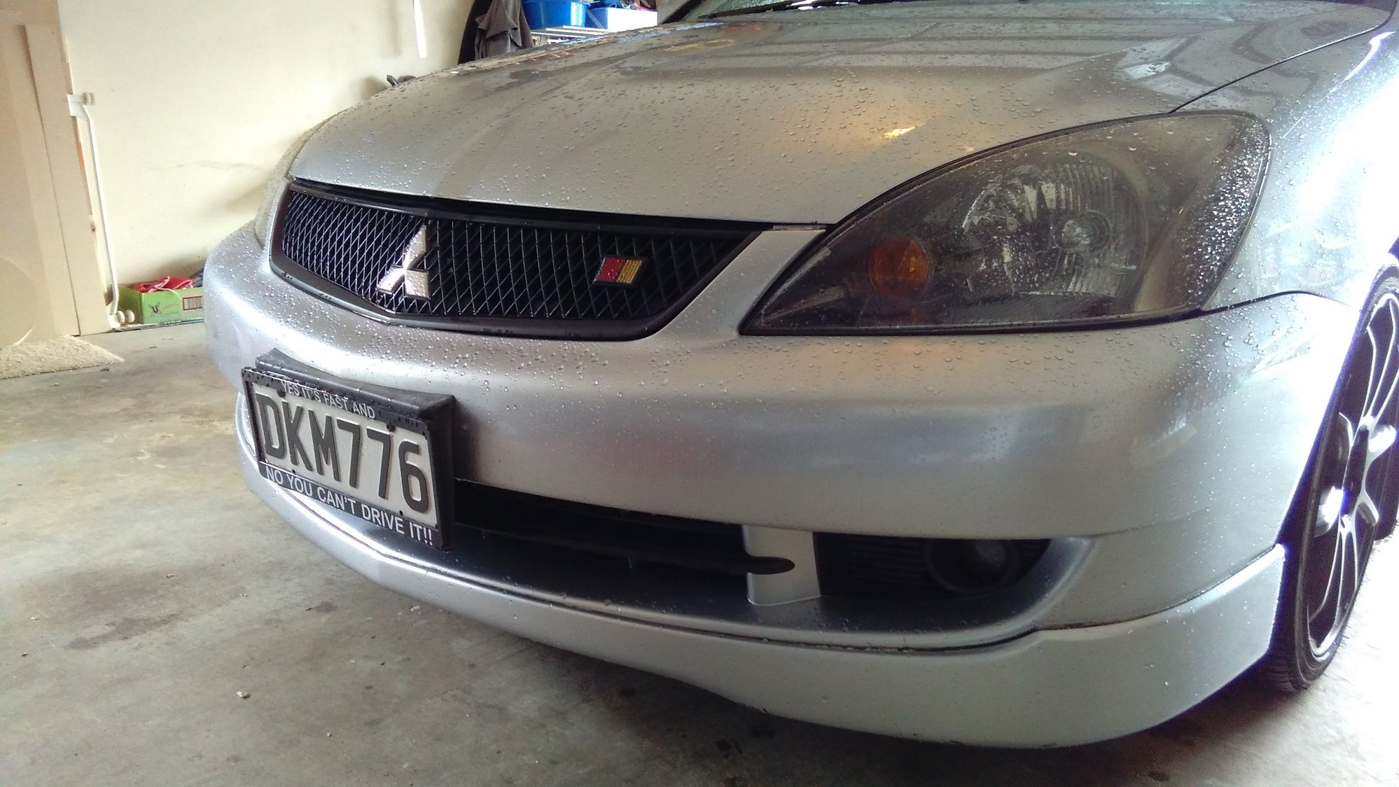

Here you can see how the licence plate is currently mounted. Right in the center and on a black support
I really dont like this support, its made of plastic which has faded in the sun and just looks ugly

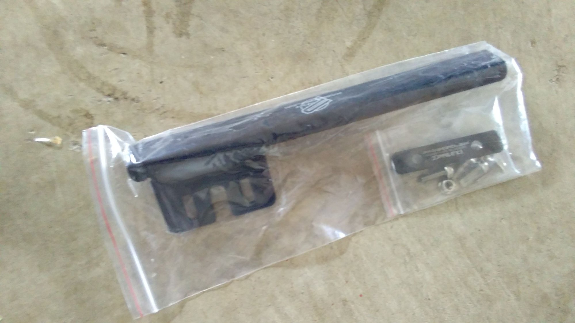

Heres the licence plate kit. Pretty simple stuff. A bracket with a L bend, one side (the short side) goes into the bumper and the other side has the plate fit on to it, even comes with four bolts and nuts.
As you can see, the kit is rather straight forward. It doesn't come with instructions so I'm presuming what I'm doing is correct haha

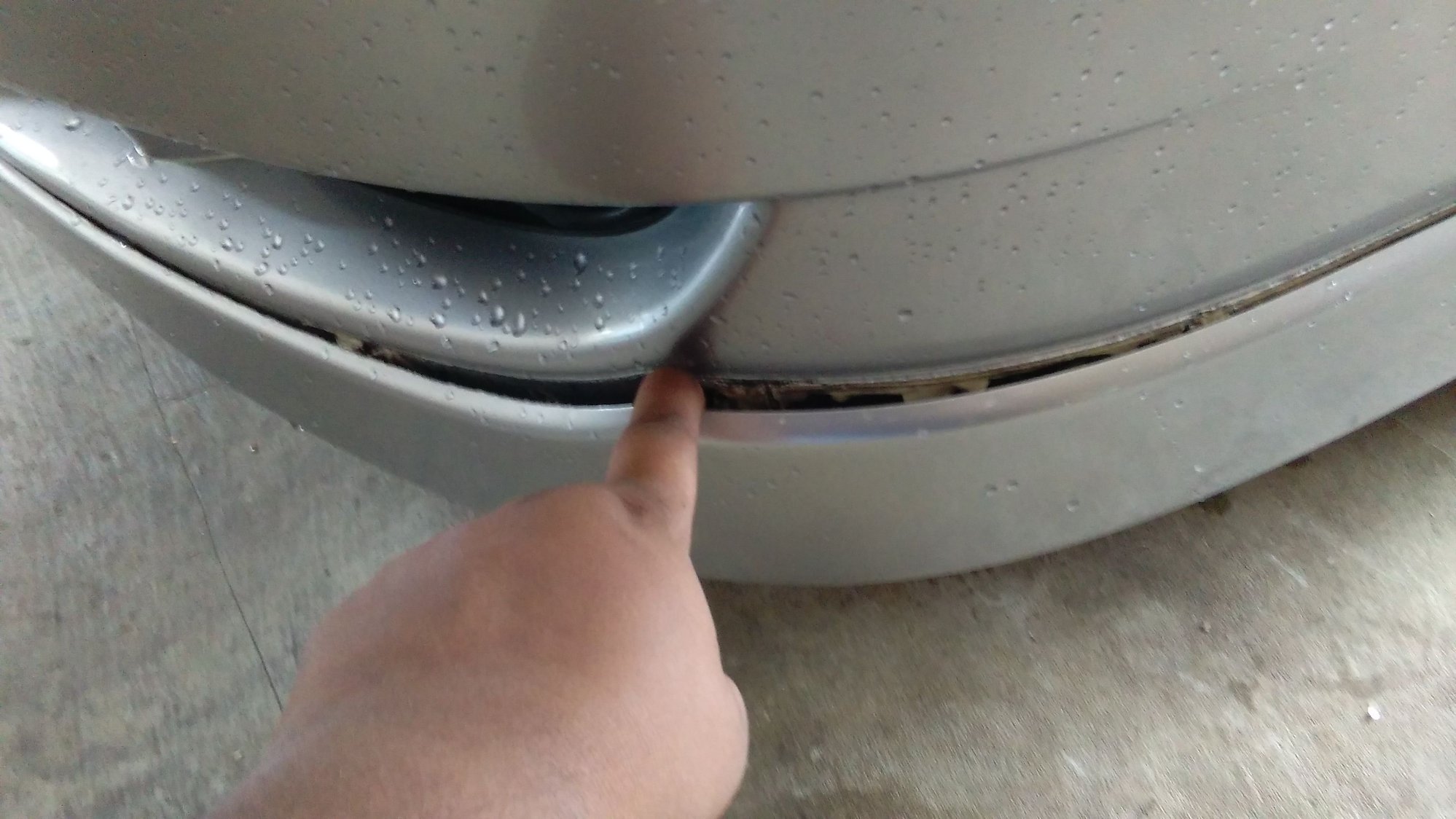

Since I'm taking off my bumper for this install, I'll also be inspecting this part of the lip. As you can see, its starting to pull away from the bumper so I want to check the extent of the damage on the other side.

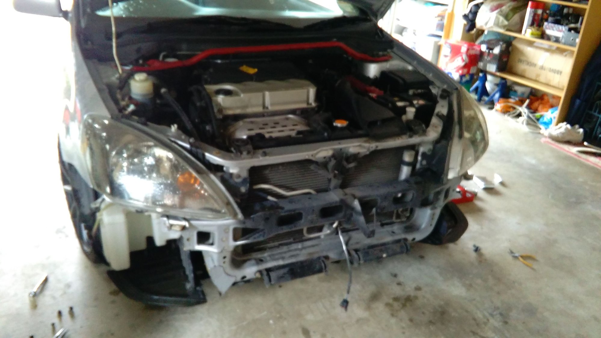

All bolts and clips holding the bumper have been removed, now its just a matter of carefully pulling it away from the car
Pulled the bumper away. Important note, if you have fog lights like i do, dont forget to disconnect the loom!I completely forgot and almost damaged the wire, yikes! Luckily, its just a single loom located in the centre, usually tucked away.<br/><br/>The bumper came away easily enough. Hmmmm, plenty of space for a intercooler huh? but lets not get ahead of my self
So I took the licence plate off, and this was the black support thing that was behind it, As you can see, ugly and not appealing at all.

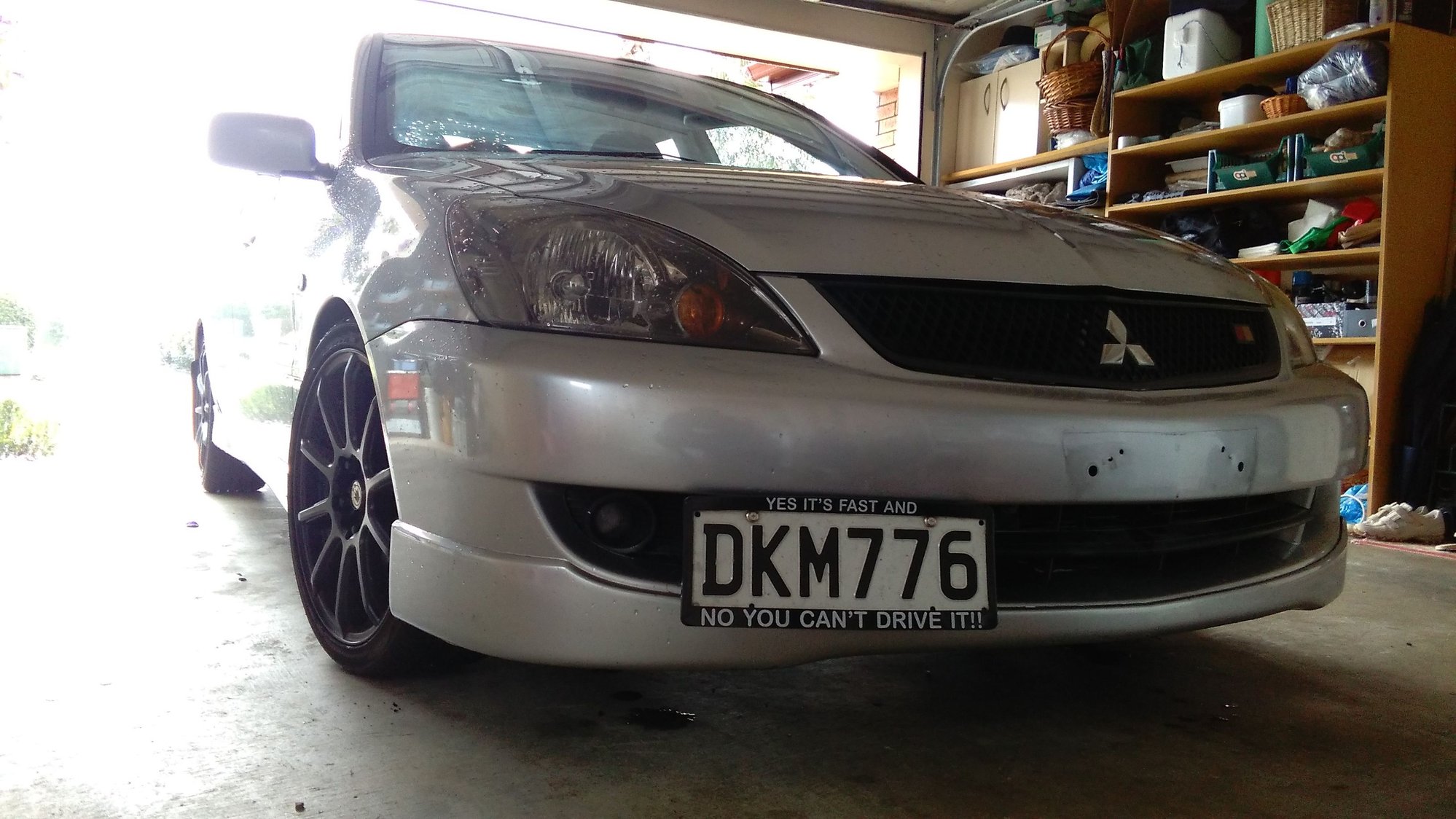

A couple holes drilled, and four bolts on nuts later, the plate is on and at the angle I want. Now its just a matter of putting the bumper back on and cleaning that grime out from the front

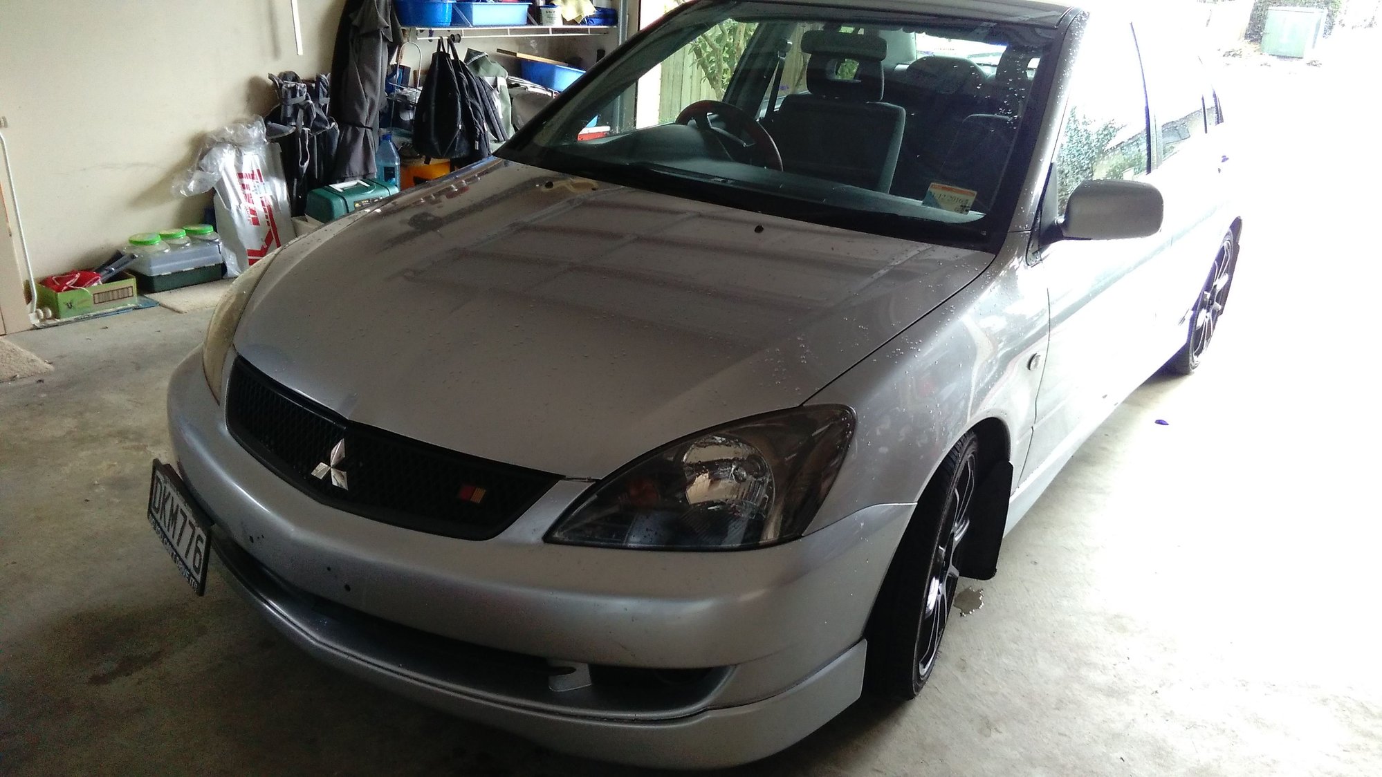

With the bumper now tightly secured and the front cleaned up, I can now enjoy the fruit of my labour :P
just a couple different angles
Eventually, those holes will get plugged up. I plan on using some body filler and sanding it back and respraying the entire front bumper as it does have a few scrapes that I wanna tidy up, plus of course fixing that lip up too.
I pretty happy with how it turned out, however at some point I will change how that bracket is as it does stick out a tad far. I originally thought I put it on upside down but when I do flip the bracket around and I try and put the plate on, it just scratches the bumper so yeah.
