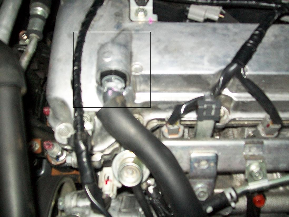

not to thread jack but i posted a thread a little while back how it felt like my car isn't hitting boost either, but like in every gear, so i don't know if this problem could be the same, but can anyone post a pic of where I'd find the pcv valve to see if mine is leaking? thanks

The PCV valve should only allow air to flow from the crankcase into the intake manifold when it is working properly. Since the air in the intake can be pressurized by the turbocharger, the PCV valve prevents the pressurized intake charge ("under boost") to enter the crankcase. If the PCV fails, the pressurized intake charge will leak into the crankcase, resulting in loss of boost pressure and hence power.It can also force the gases out the rear PCV into the turbo. This is why with some PCV failures oil is found in the compressor housing,outlet pipe, and intercooler piping.
