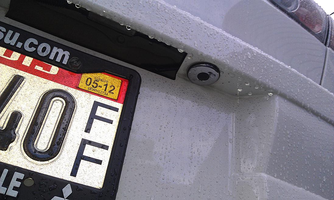

Anyone know who/where the thread of relocating the trunk button is?? I've been looking for days and can't seem to find it!! Tried the search with various different key words... =(
I believe the button was relocated to the rear bumper by where the license plate is. Very stealth.
If anyone could point me there, it would be appreciated...
Thanks!!!

I bought a Do-Luck trunk and couldn't bear the thought of drilling into it. I'll go find the pics.

Screw digging around for posts from early 2010, lol, it's easier to just run outside and take another pic, so here goes:
Attached Thumbnails Relocation of trunk release button thread??-imag0230.jpg

THAT IS WHAT I'VE BEEN LOOKING FOR!!!!!
Thanks chi-town!!
Ok now... the question is... how did you extend the wiring and get it into the bumper?? I'm assuming you had to take a drill to the bumper?
Thanks chi-town!!
I am also thinking about getting the do-luck trunk!! It's a damn good looking trunk!!
No drilling required. Just remove the inner trunk wall lining and follow the wires on the left hand side through a rubber grommet to the outside of the car. This is where the wiring is routed for the license plate lights, so you could essentially just start at the license plate lights and follow that wiring up to the grommet as well.
Just a simple wire extension from the loom to where I needed it and voila. I will say, however, that the plastic connector body used for the F.A.S.T. trunk release is not weatherproof so you will either need to eliminate it and hard-wire everything, or pack the backside of the wires/pins with silicone and put a rubber o-ring around the male connector end before installing. I know this from experience since mine corroded after about 6 months and I had to remove the bumper again to just cut out the connector and directly solder both wires for the switch.
