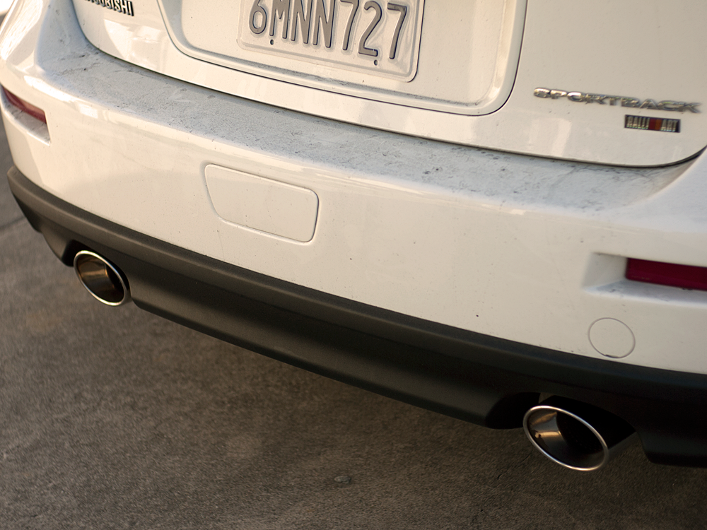

Thank you razorlab, any suggestions on brand for that turbo back exhaust, or at least things to avoid?

AMS is probably the best downpipe and I really liked the magnaflow catback when I had my Ralliart:
