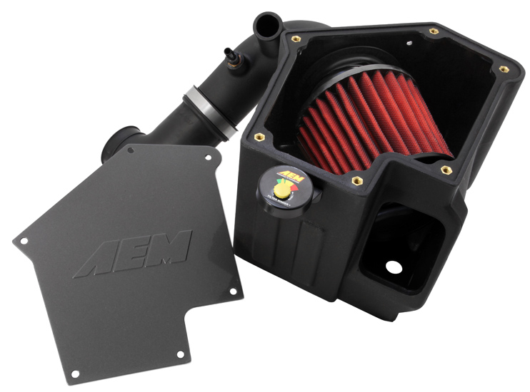

I have a question about the AEM intake that goes with this Map.
I know there are several different intakes.
It says ONLY AEM Intake.
Well i got myself an intake it is AEM it's the one that comes with the box to enclose it.
Is this teh correct one?
I am doing a TBE and I have the pill so just need to know if this is the right Intake and i am golden
Thanks

Originally Posted by RALLI||||||RAT
Hi
Thanks
Yes, that's the one.
awesome I'm all set to try it out
Thanks for everything man
