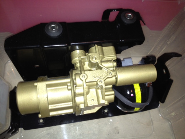

Old Dec 1, 2015 | 06:22 PM
  #54
TRK_RDY's Avatar
Joined: Jan 2015
Posts: 20
From: WI
Just got mine back!
I used the same guy, just got word its done, check it out!

Old Dec 6, 2015 | 10:04 PM
  #55
neogeo64's Avatar
Joined: Apr 2010
Posts: 938
From: Oakland, CA
Looks better then new!
