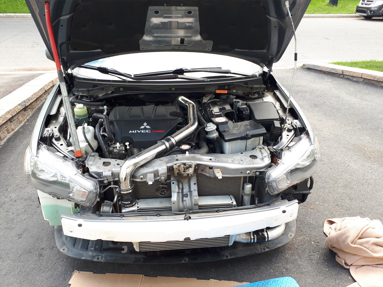

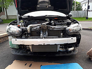

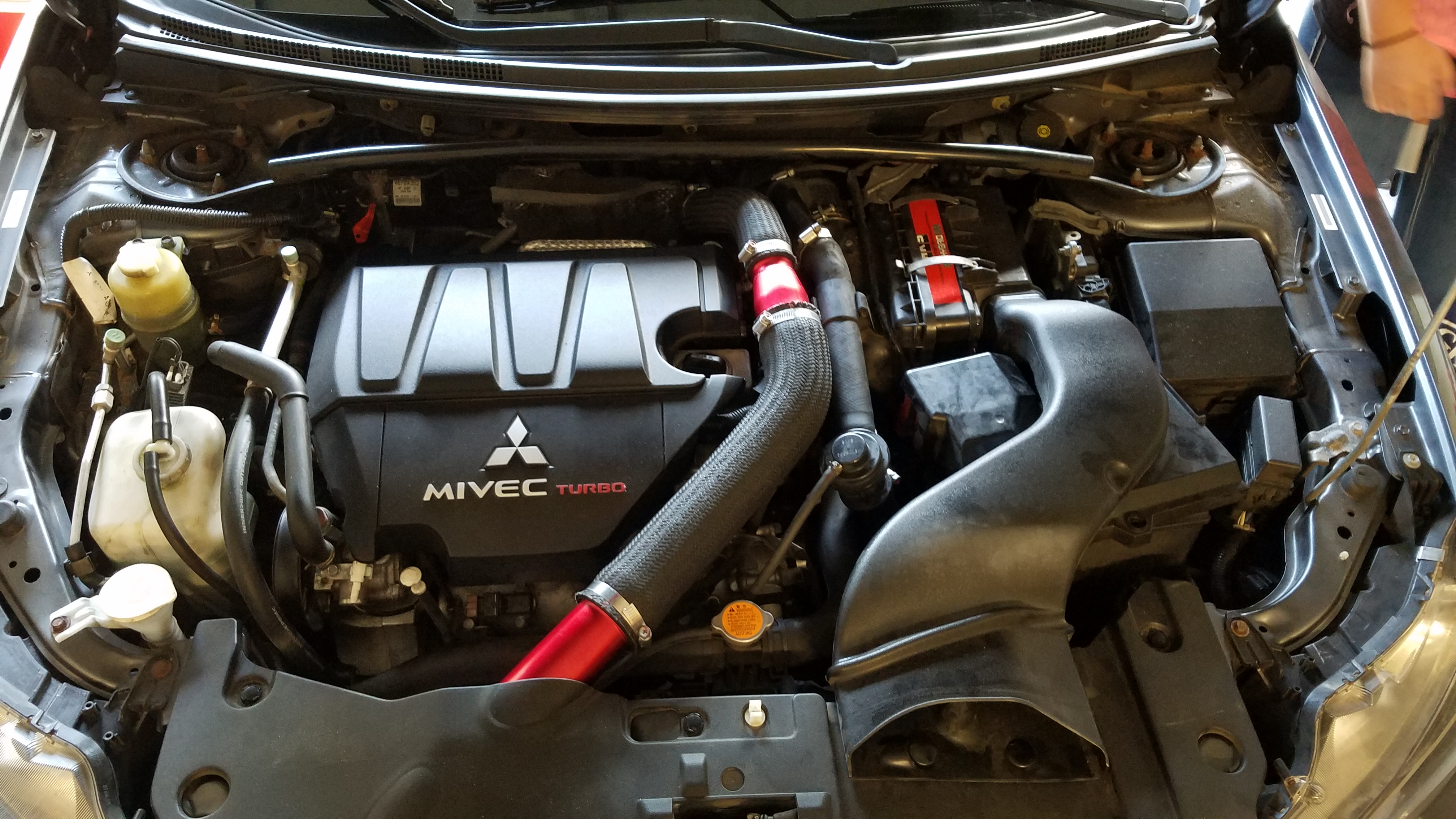

Finally hooked my ralliart up with an evo x intercooler and piping. Took about 2 hours thanks to this thread and wanted to say thank you to everyone who posted on here. Tremendous help guys thanks.

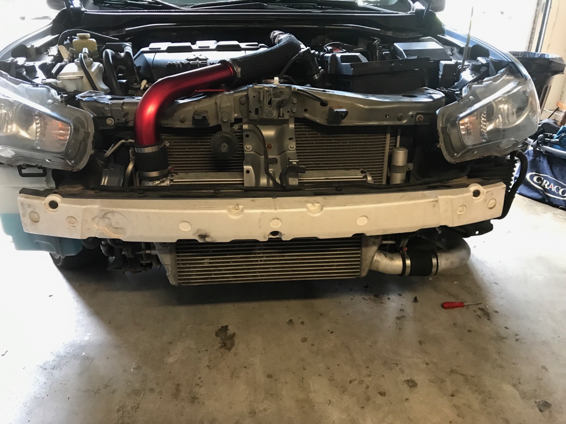

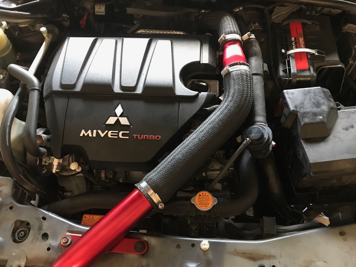

I just installed a stock piping and Intercooler setup yesterday. The EvoX FMIC works perfectly with the RA LICP. I used the EVO clamps and hose. I have the Evo licp bit didn’t feel like messing around with everything to swap that out right now.

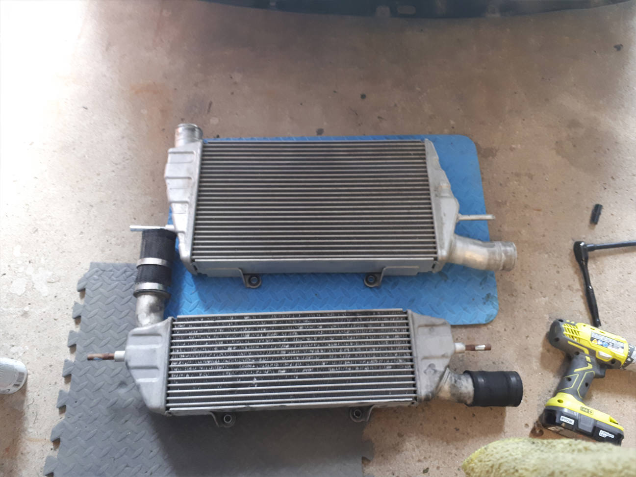

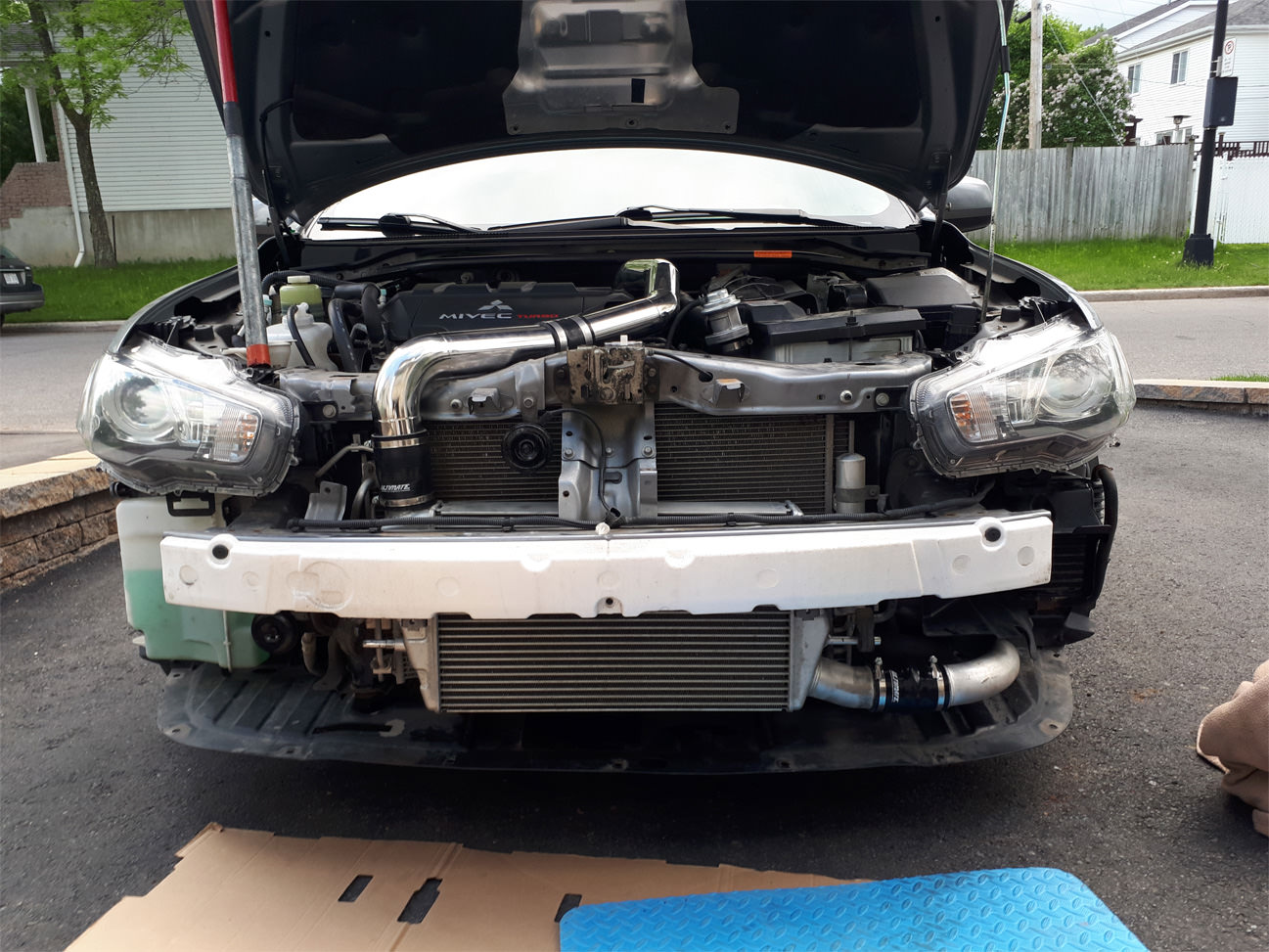

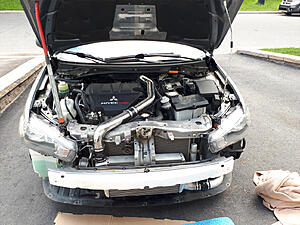

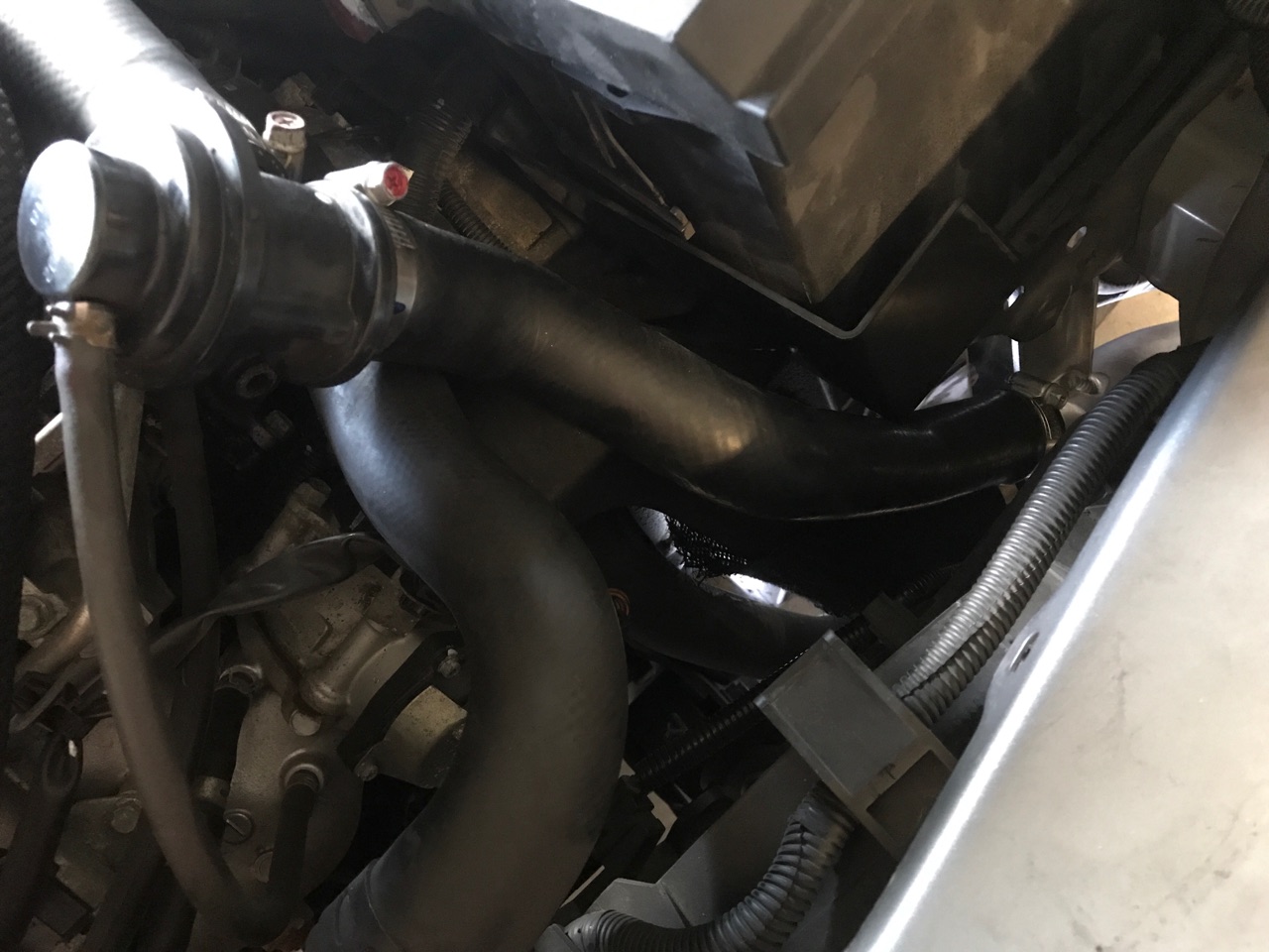

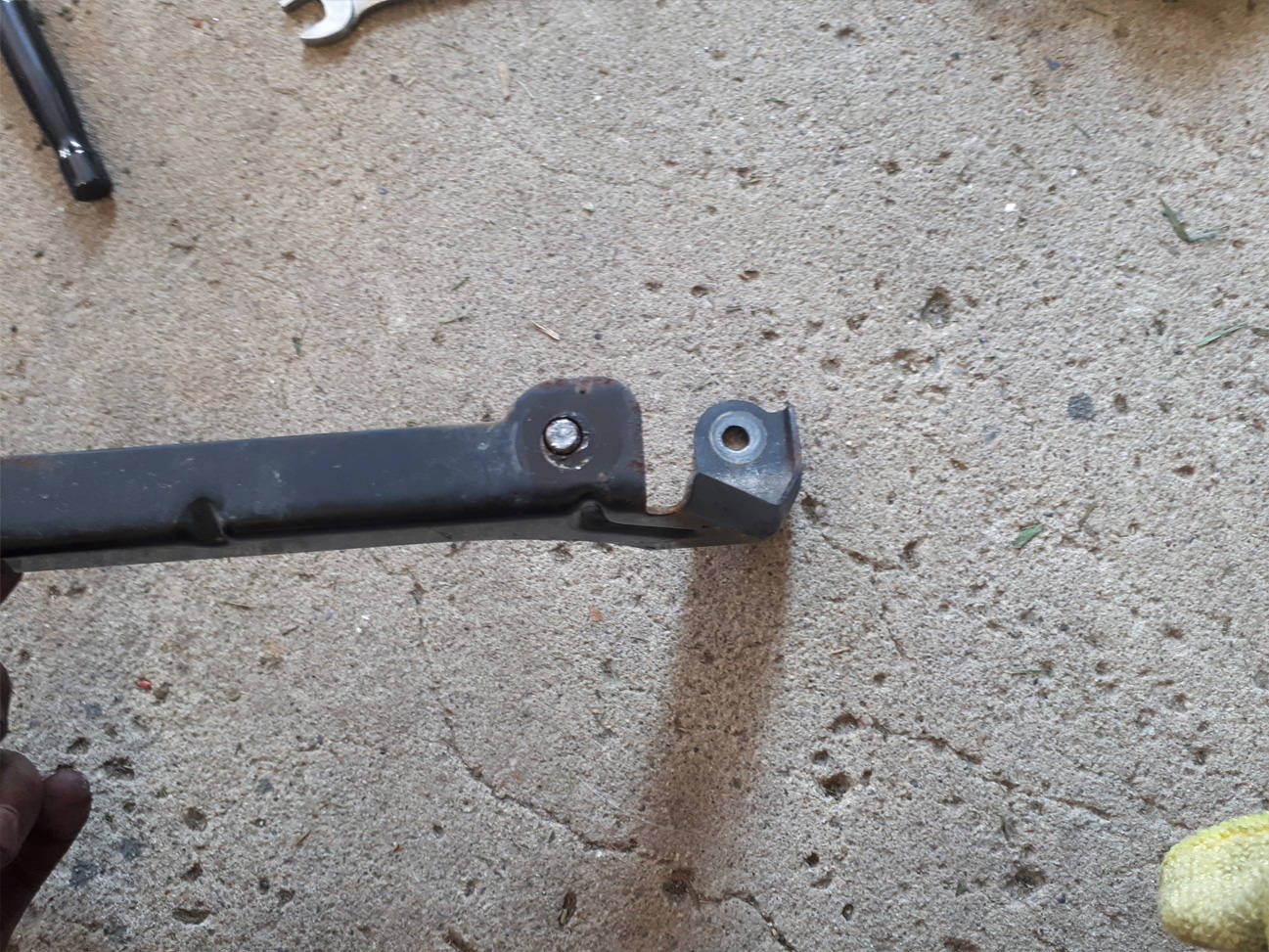

Just did the whole Evo X intercooler swap, what a pain in the butt to install the lower intercooler pipe, at the same time both bolts holding the stock intercooler broke on me , I managed to remove them by removing the bracket. Overall really happy with the results.
