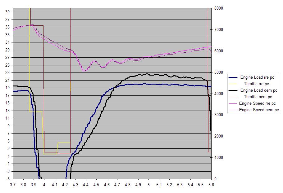

how is your boost sensor mounted? my guess that itis NOT directly onto the manifold.
the lean spike has a lot to do with the lag time from the sensor reading boost within the manifold!
any legth of line adds delay to my aem sensor.....honestly.
as your boost after shift trace looked similar to mine when i ran a hose to my sensor.
i still have a lean spike/knock issue after shifts, but by installing this device to mount my aem boost sensor onto my oem manifold, a majority went away.
look @ the difference between 12 / 19 psi!! let alone the time delay to!
same sensor, 1 is mounted with this mounting block from rre:
scroll midway down to Manifold Differential Pressure (MPD) Sensor Adapter
http://www.roadraceengineering.com/newproducts.htm
dont buy the evo unit, as they charge $40- more on the website??
& the other way was having the sensor "t" into the oem location for the fuel pressure regulator & oem boost line.!!
