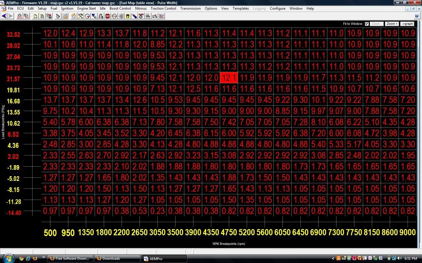

I am curious why in my fuel map I have to set my afr's so low in the lower boost range than up top.
For example from -14vac to 8psi I have to keep the afr's between 2.25 - 5.00 at most or it will start going lean on my actual wideband. Is there a setting or setting to adjust this. Even at idle my afr's are nearly zerod out
In the upper boost range it seems the afr's or target numbers are close to the actually air fuel output (wideband).

pic added

Do you think that the value in the grid is the desired AFR?
If so, then you are wrong. You are looking at your map in injector pulse width, not AFR. On the AEM EMS, when you are working with the FUEL MAP there is no way to see it based on desired AFR, only RAW, PULSE WIDTH, and DUTY CYCLE.

thats what I was getting at, I wasn't sure if there was a target or not.. thanks for your help!

You do have a map with target a/f ratios, but that is on the wideband feedback map, not the main fuel map.

That's pulse width son...holla

I like view my fuel maps in Raw. It make it easier for me. This is not AF thou.

I use the raw view as well.
You can use the auto mapping for target AFRs.
