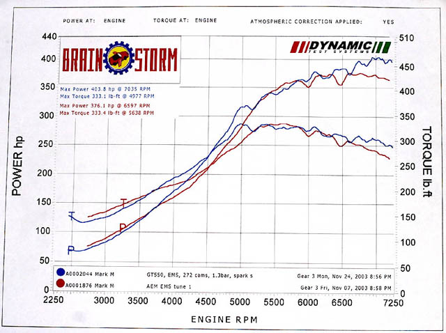

I am definitely having a problem here with the stock ignition. Going to upgrade and see... My tuner's shop is moving this week so I am out of the loop till next week.

I don't have experience with the AEM or this dyno so..., but when I have run into ignition missfiring under high loads in the past, the power output/dyno graph was far more eratic/abrupt compared to what I am seeing here.
This almost looks like the AEM is making adjustments possibly due to the knock correction or possibly eratic boost control?
What do the data logs show?
The stock EVO coils actually have the igniter built into the coil, so an aftermarket ECU cannot put an amplified signal into the coil and burn it out. The problem with the emange happened because with the ignition on and the engine not running they were byassing the igniter all the time. So if you left the ignition on with the engine not running for more than 15 seconds it would burn up the coil. I do not believe any of the other ECU systems have this problem.

I had spark blow out on mine as well while it was still running (down for a complete longblock buildup, etc.). I didn't have a great deal of time to tune other than to/from work, but I had no boost control (1.1 bar wastegate pressure) and I was seeing bad blowout at times. I was still a bit rich (at 10:1), but knock correction wasn't what was doing it; I watched all of that and it didn't coincide.
FYI, the AEM can and will burn coils if set up improperly. Don't mess with those coil settings unless you know what you are doing. I had stock plugs, BTW.

The car has been running like crap on boost with the spark problems I mentioned above. I swapped them out for the hks irridiums and same problem.
For the heck of it, i put in brand new ngk ir7a-g's- the factory plug and the difference is simply amazing. The car pulls strong now without the backfiring under boost at 6k. Before with the hks s40's or the burned up stock plugs, I would have major problems at 1 bar -1.3 bar. I turned up the boost with the mbc to 1.7bar and it pulled really really hard with my 94 octane mix and no spark problems were evident. The motor just feels really strong. I turned the boost down to stock and will leave it there till I get my uego replaced or more dyno time.
Funny how something like which spark plug you use can make such a major difference. I gapped .25 btw. I do not know if all of the spark problems are cured but it is a major improvement. I suspect the factory plug is pretty well optimised for this car.
I cannot wait to dial this in at a respectable boost level after the aem ignition goes on monday. Even if the problem is gone, I figure that upgrading the ignition will make more power.
In any case the car pulls much harder now and the idle with dual 272 cams is so good it sounds basically stock! The aem is becoming better than stock in drivability. The cold start enrichment is pretty dialed also. It is also an improvement to use the check engine light as a shift light!

The only real issue with this setup as it relates to the AEM is that Mitsu's coil dwell is set very high on these coils. The AEM can get unhappy about this. The easiest fix is probably doing a CDI box inline with the EMS. This is a problem specific to Evo's. In fact we've never seen a coil with such a high dwell setting.

Could the isses also be related to the AEM's wasted spark setup? From what I hear, Supra guys have run into this before

With any wasted spark ignition, it is necessary to have a separate ignition box - MSD, AEM, Autronic, HKS DLI, etc.
Supras always get an HKS DLI along with the AEM EMS, and it works great.
