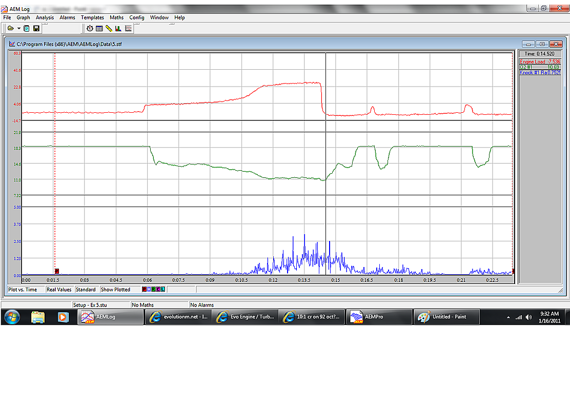

For guys running an EMS I know it doesn't display counts of knock in the log but rather knock sensor voltage.
So how much is too much? I hit about 2.5v at the top of the spike.

What boost and timing at that point?

I think about 25 psi and 6 deg timing
93octane

Stock or built engine? I've seen more than that on built engines regularly, especially when making power.
My engine when it was stock sometimes made a little noise up top and I typically dont see much of a concern until its getting in the 3+ volts areas in the mid to high rpm areas. You can usually tell when its knock, try taking a bit of timing out and/or lower the boost a little and see if it goes away. A sure way to tell is some high octane fuel...
There is a Supra I've tuned that the engine is very noisy and pretty much has a regular noise baseline over 3 volts all the time. This is with 93 octane, high octane, and even e85. Some engines are just loud when built and the car is highly modified...

I have a few recommendations. I would switch to an internal log. This will give you more resoution.
http://forum.aempower.com/forum/inde...c,23911.0.html
As for knock, you should always do a baseline pull, to establish what your normal engine noise level is. Alot of the time as boost goes up the engine will generate more noise. If you have a noisy engine those numbers are fine.
The big thing to keep an eye out for are the big spikes in knock. When that happens, you might want to work on your timing at that spot and or a little before the knock event happened.
Big afr swings and huge timing jumps are the biggest cause for knock.
And to answer your exact question, how much is to much. Well, that depends on your engine build and it use case. I my built 2.0 my here is my knock table:
0.1171875 0.1171875 0.44921875 0.80078125 1.1328125 1.484375 1.81640625 2.1875 2.48046875 2.75390625 3.0859375 3.30078125 3.515625 2.5390625 1.7578125 0.99609375 0.99609375

my numbers in my knock cal table are similar to his.^^^^ built 2.3 here. agreed on the big spikes also. my rule of thumb is if you see higher spikes, take timing out there and see if it goes down. if so it was knock, if not, its engine noise.
