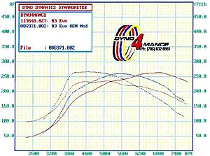

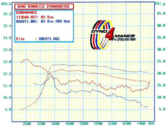

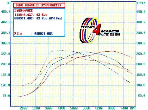

I totally forgot to come back and post the graph I have. Andrew is compiling more graphs at your request, George, but here is mine with Manuel overlayed with power and torque. The only mods on my car are cam gears set at -5,-5 on stock cams, a dump-back exhaust (stock O2 housing), and the XEDEflash.

Here you go.
Attached Thumbnails Information for Boost Solutions-noizevssilver1.jpg   Information for Boost Solutions-noizevssilverafboost.jpg

I don't even pretend to be a 'tuner', but it is obvious to me that silverevo8's car is just 'tuned' far too rich. You can even see if you look closely a slight rise in power at approximately 6300 RPMs where there is a small spike in the A/F ratio. The precipitous drop in torque mirrors the richening of the mixture.

Manuel's low end torque is actually really nice, but he was running A LOT more boost than the rest of us. All these maps are 93 octane runs.
