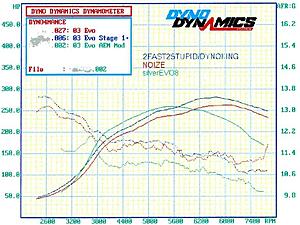

another

Originally Posted by Noize
another
Thank for posting since the goal to help Manuel and get his car right. The biggest problem Manuel has had is with his car being very rich. He showed me a picture of were he parked his car and the grass had died and had black sut on it. Hopefully with few more hours of tunning it can be corrected
Peace,
Snoop

Thats why his gas mileage is so bad. My car makes almost the same power, yet gets stock like if not better gas milage.
