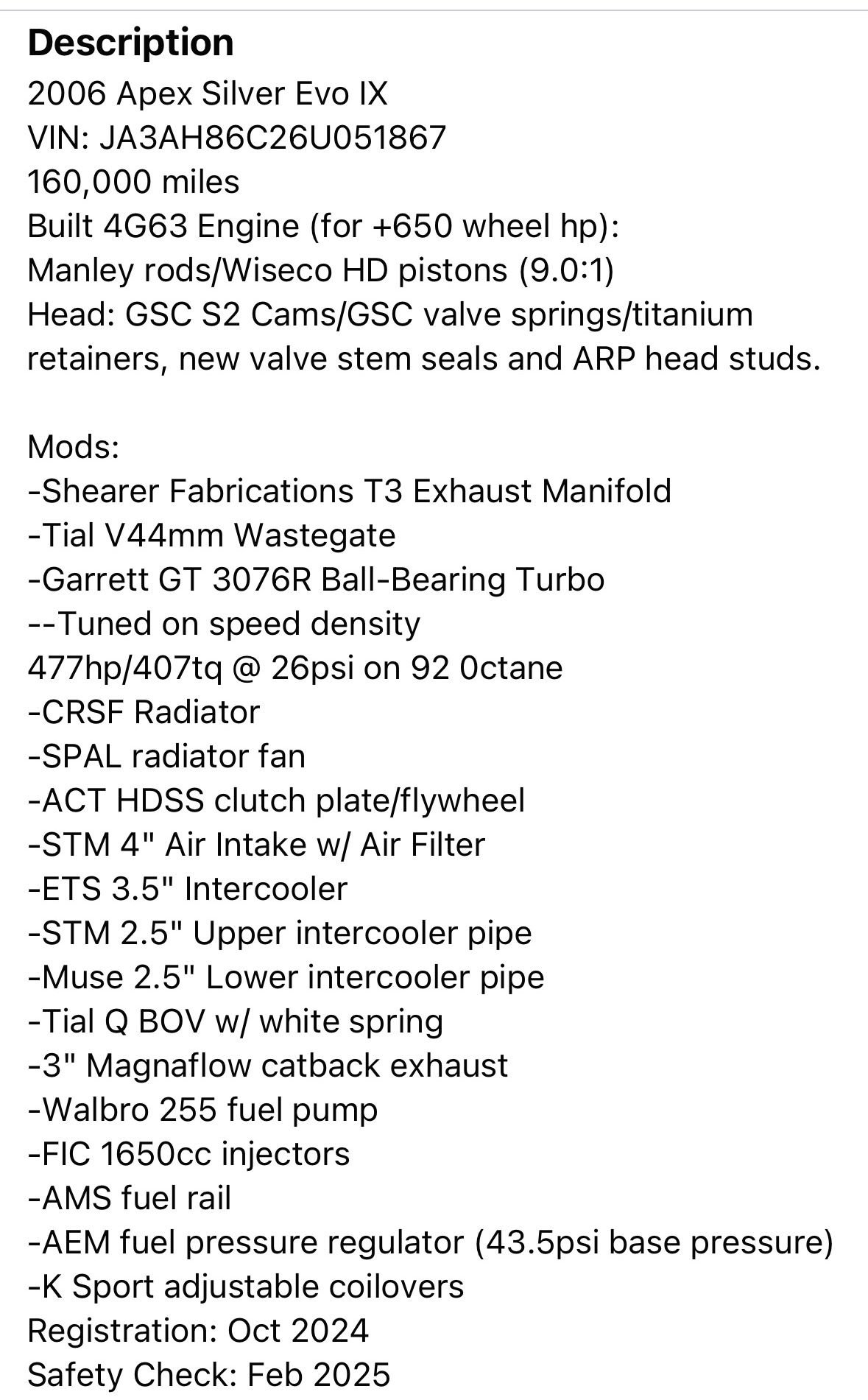

just wondering how hard it would be to have my Vehicle pass the TUV and Registered in Germany. My Evo 9 has some mods and I been told I will likely not pass. Any help and guidance would be very much appreciated! Mods list listed below!

If under US SOFA status...base will inspect for free. Excess exhaust noise, too low, and worn tires (1.6 mm across the width) are the common failures.
Modifications can be an issue away from the US areas...as cars can be confiscated. Germans must have all modifications listed on their TUV...road side check points are not uncommon...
We've been fortunate to only have an issue with a too loud exhaust, but a 'db killer' solved that (temporary).
Evo's are a hoot in the land of the autobahn...

I left Hawaii and went to Vilseck 10 years ago now, and the bigger items that give you trouble are the DB level of the exhaust, height of the car and if I remember correctly tint on the front half of the car is not allowed.
