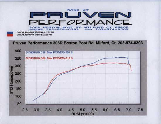

Here is my dyno designed BR440 reflash on the Buschur Stage 4
This was done with near ideal conditions and perfect fuel
This was at just under 21 psi
Again - this was our first BR440 on the dyno and we spent long hours to max it out at each boost level
Your BR 440 seems to be within 10 whp os this result so I think it is within spec at that boost level
Here we are turning the boost to the sweet spot - 23 psi where this turbo starts to become a real road menace. The BR440 just need some boost to get into its sweet spot
This was with 100 octane for saftey - but still on 93 octane type a/f and timing setings blue is the BR and red is a HKS 3037 - notice how quickly the BR440 spins to boost
Here is the max deal 27 psi - about as hard as I would push this on a customer's car with half 100 octane and half pump gas
Still a pump gas style tune but the xtra furl for saftey

Notice guys - on the BR440 the power comes up good - but does not slam hard at first, it builds like a smooth wave to the end of the power band
The stock turbo slams in hard and boosts up the trq immediately = but then it falls down to the red line fairly hard
On the street the BR440 will walk the stock turbo car with same power likes its standing still as the Br440 pulls a lot harder up top
Remember - I did not build or design the BR440 - I just tune them
I personally happen to like its power band and the way it drives on the road
However the trq is a bit low for the boost levels - IF you compare it to the stock turbo
Finally - please relaize that this maniac customer with this dyno sheet was attempting to get ready for a race next week and we pushed his stock turbo to the edge that was humanly possible - his results are NOT typical on a stock turbo with stock fmic

Repairing that leak will boost your output into the same mid to high 350 whp range as the sheet I just posted - - ASSUMING that all other conditions are equal
By the way your car was driving - when I drove it it was making easily over 350 whp with no doubt
