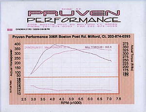

Here is our hard charging Armed Forces member and loyal customer member LDSTANG50
Here are his mods
Power Enterpizes Electric Boost Controller
700 cc injectors
AEM intake
Full 3" Tubro back exhaust
272 / 272 cams HKS
Buschur upper ic pipe
Fidanza adjustable cam gears - (I will disclose adjustments only upon customer request)
Here is his base line with his previous flash (set for othetr mods and no cams)
Attached Thumbnails Tuning with Dyno Flash - Case Study # 12 - boost problems !-liam1.jpg

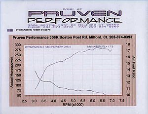

Making adjustments
Attached Thumbnails Tuning with Dyno Flash - Case Study # 12 - boost problems !-liam2.jpg

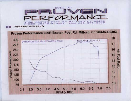

We are getting closer - BUT - the power is not nearly where it should be - time for a boost leak test as a diagnostic measure
Attached Thumbnails Tuning with Dyno Flash - Case Study # 12 - boost problems !-liam3.jpg

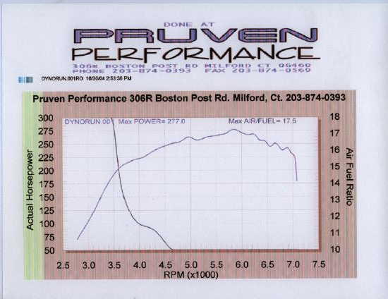

There were a total of 4 boost leaks - some where down by the fmic - some where at the bov flange - all fixed they added up to some significant gains
However - we are still too low on power and erratic boosting
I personally don't care for the Power enterprize boost controller so I suggested the Hallman pro to my customer and we put it in
Attached Thumbnails Tuning with Dyno Flash - Case Study # 12 - boost problems !-liam4.jpg

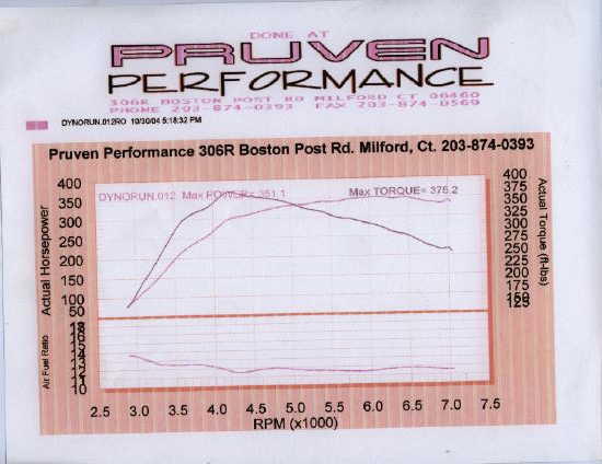

WOW - big gains with the Hallman - and the tune is getting closer
Time for some tuning
Attached Thumbnails Tuning with Dyno Flash - Case Study # 12 - boost problems !-liam6.jpg
