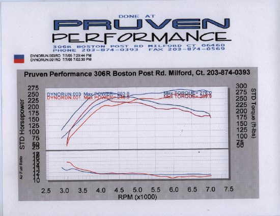

I am very proud of the results of the V3 boost controlling flash on a bone stock MR with 93 octane

Nice smooth curves and A/F too. Can't wait for you to come back to the burgh to fix my car!

Actually - I made 320 whp on a SCCA stock class MR with the boost controlling V3flash and 100 octane fuel

This above flash was a mail in - maybe I did not make that clear - as you can see it was a A - B test - nop tuning was done or was needed - the mail in was perfect
The V3 is included with every through the mail tune where the customer does not specify that they have a boost controller
Mail in flash is $199 plus shipping
