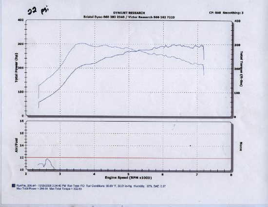

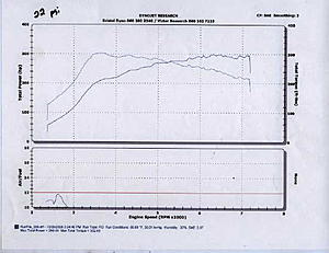

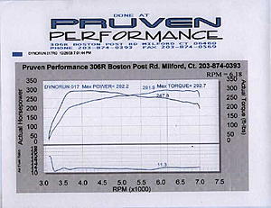

Just to follow up on this thread - there was NOTHING wrong with this gentleman's tune what so ever
Here is the dyno sheet from the other shop which showed a RICH a/f - in fact the a/f is not even recorded on the dyno graph
Here is the sheet the customer showed me
NOTE - the tune looks perfect and power and tq levels are normal for low boost and no cams

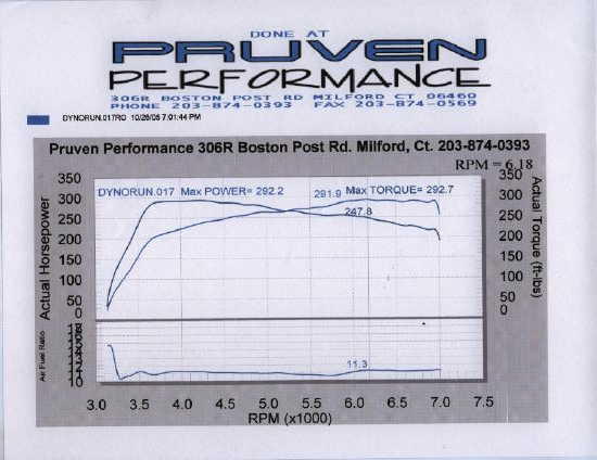

Old Oct 26, 2005 | 04:11 PM
DynoFlash's Avatar
iTrader: (91)
Posts: 16,850
From: 2003 Evo VIII - Silver
The customer came back to our dyno and without changing anything we drove the car onto the dyno with the same 20 psi and this is what the dyno sheet showed
You can see the tune and a/f is perfect
Attached Thumbnails 0300 code and 10:1 A/F after flash-victor2.jpg

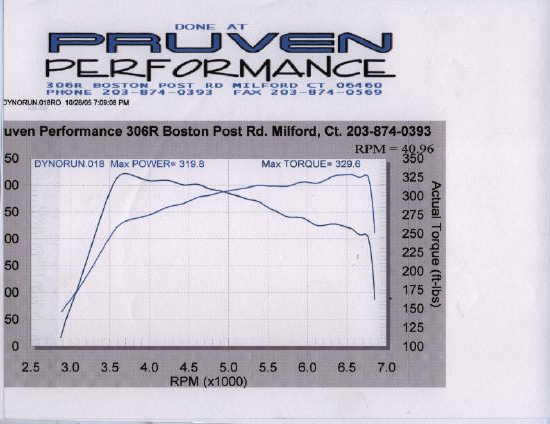

Old Oct 26, 2005 | 04:13 PM
DynoFlash's Avatar
iTrader: (91)
Posts: 16,850
Finally - we turn UP the boost to 22.5 psi peak falling to 20.5 and this is what we get - a perfect tune with POWER TO SPARE - nothing worng with the car a false alarm
Attached Thumbnails 0300 code and 10:1 A/F after flash-victor3.jpg
