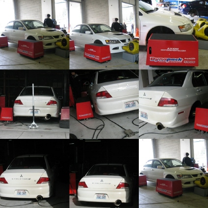

and the pictures on the dyno -__0

Wow, those are pretty weak numbers.
Was your dynoflash tune custom?
I made 340whp on that dynapack will just a tbe and Vishnu reflash

i did 235 stock on a dynopack, hmm, something is off

Something is really wrong. Do you have any boost leaks at all? Even though your boost guage reads the PSI you want, you can still have a big leak somewhere.

Dynapacks are one of the most expensive units. True, different dyno's
read different results, but there is something most definatly wrong with
that car. Most modded Evo 8's make around 270 on that very dynapack.
It's not the dyno, its the car. Might be a leak, or a improper tune, but
something is wrong with the car, not the dyno.

Yeah, something is definitely off, and no, it's not just a "bad tune." We have one local 04 who has all the same bolt-ons, but no matter how many times he gets reflashed or tuned with SAFC and wideband, he just never makes power. The most he has put down is 255, and that's with the help of me and a bunch of other local DcEvo's. We can't find boost leaks or any problems, yet after switching on/off many parts and getting it retuned 3-4 times, it just isn't powerful. We haven't done a compression test yet, so that might tell the story, but he's basically planning on putting it back to stock, getting a IX, and carrying over his same basic mods to the IX, which I think is a good idea.
In this case, either something messed up on the dyno at that time, or something is wrong with this car.
