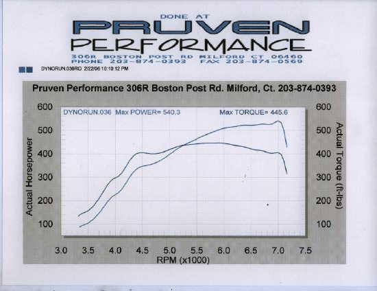

Case study # 160 - 540 WHP pump gas IX with reflash
Guys - nice to have the first 500 whp IX in the USA
This car is far from done, we ran out of fuel pump and now must build a fuel system of some kind to go further
This car is Full BR Stage IV
GT35 R Puven spec turbo wheel
HKS Twin Fire
Buschur Alcohol injection kit
820 injectors
IX reflash by Dyno Flash
Pruven 2.3 Stroker kit
Stock head and stock valves and springs
This pass was on only 28 psi and pump gas with the alcohol and a 15 alcohol jet. I am sure there is much more power left at higher boost, however there is not enough flow to supply the injectors and we need to go to 1,000 injectors
Now the customer must decide which steps to take next
It could be a nice 500 whp pump gas dialy driver - or - the next 9 second evo ?
A wonderful car - simply sicko fast, no head lights so could not leave the parking lot (headlights are with evo dave)
Hopefully it will be a 9 second street car by the time we are done

This was stock IX intake came and HKS 272 exhuast cam
There is more tuning work to be done where with timing and MIVEC to snmooth out the TQ after it spools but we will wait for that as we have more hardwear needs to complete the project
Basically the customer must decide what kind of beast he wants - wild or INSANE
After 550 whp we need to convert to speed density also so the nest step becomes more complicated

Ugh, that graph is buttery smooth! Incredible for a 35R, don't you usually get more of a spike at 6,000 rpms? Must be the MIVEC.........I WANT I WANT!

the 35r really comes alive with the 2.3 keep in mind. And dont forget about the MIVEC...

nice tq curve!
