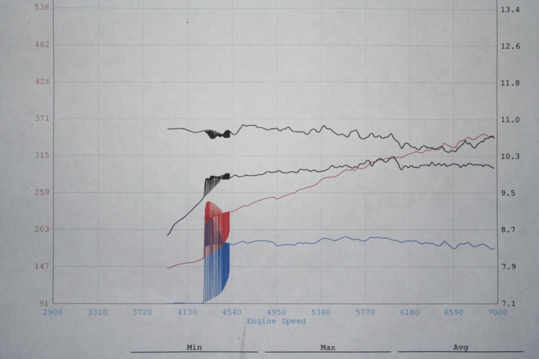

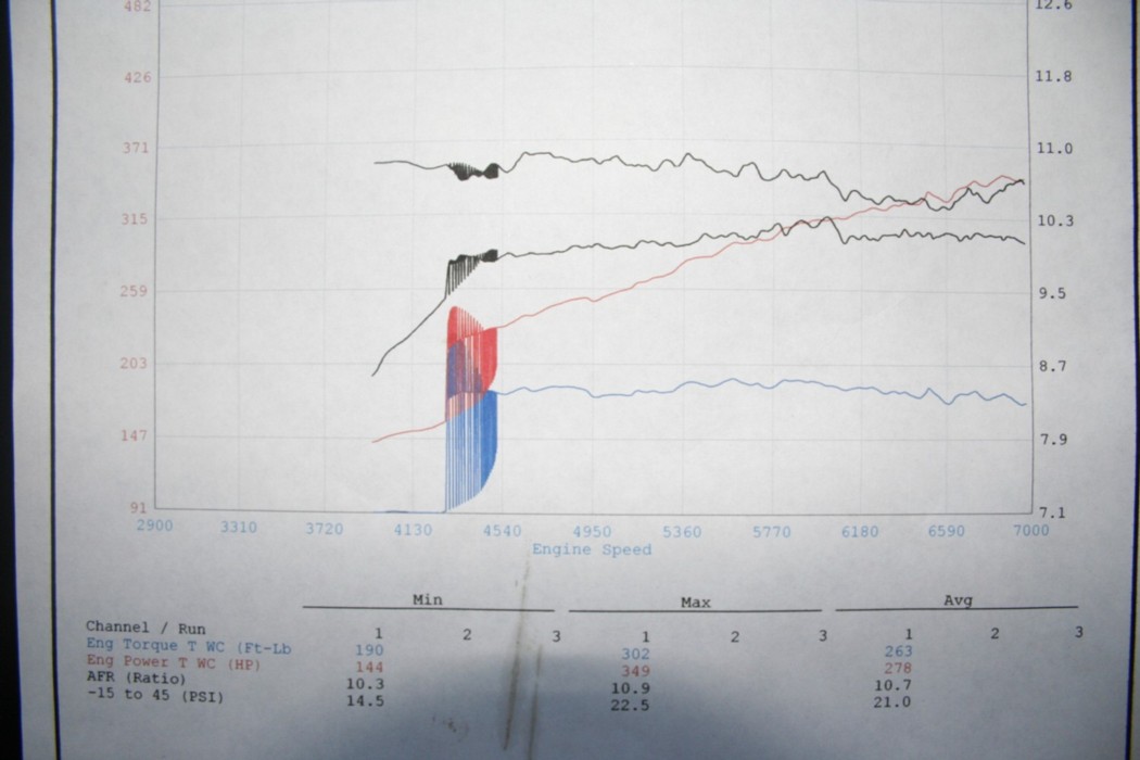

I was out of town so this is very late, april 11 Ohio. Started with 344 whp 292 wtq off of a Dynapack dyno and AFRs were in the 13+ (I dident know till Al did a run.........) He yanked my Greddy e-manage out and went back to the stock ECU only did a few pulls and got 349 whp 302 wtq on a mustang dyno @ 10.9 AFR. Very nice but havent been able to really unleash cuz my stock clutch started slipping on the dyno.......... Clutch in soon!

Yes it was on the Buschur Mustang Dyno, also 23psi to 22psi to redline on 93 octane.

How good was the spool on that 3076 kit? Where you reach full boost @ or how much boost was being pushed around 4K?

Sorry guys here is a pic of my dyno slip, very late spool, wish I could get it a little sooner....... about 4200-4300rpm but It hits hard and fast. They are as big as I can get them tell me what you think.
