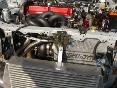

Not much progres but making head way
Every step I am going I realize what great work www.buschurracing.com did on my car and how amazing a mechanic Dan Buschur is - its a joy to work on and prep a well wrenched and set up car
Just to mention my favorite tool - my MATCO 3/8 drive Electric cordless imapct gun - man this sucker is a joy and especially is great on T bolt hose clamps
Today I installed the re-routed fmic pipe to allow room for the alcohol kit
Thanks to Kenny at www.pruvenperformance.com a gifted fabricator and great guy for helping to make room for the alcohol kit
BTW - if you need great T-Bolt clamps - amazingly good hose couplings at a cheap price and great service
http://mazworks.com has it all at the best prices
I tested two different alcohol kit controllers and found the new V 2.0 from SMC (which I sell www.dynoflash.com) to be great - you can adjust the spray pressure from 40 psi to 90 psi with 4 steps in between, of course I am on the highest setting but on a street car it may be prudent to use one of the lower settings to conserve alcohol and also leave some head room in the event of an unepected alcohol kit failure so the tune will remain safe enough to last till you realize it. Also i am now advising all SMC kit users to locate the controller on top of the steering colum so you can eye bal the yellow spary light and low level indicator light easily.
I also conducted a full 45 psi boost leak test and everything is tight
More updates tomorrow
