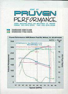

This is my favorite one

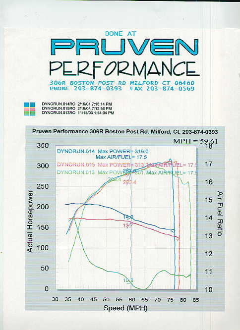

Diff angle

Previous tune - from Oct - pressed up against the knock activity threshold and then taken back a safe margin - (assumed at the time it was a bad load of gas) with a nice rich and safe a/f - vs. a very agressive and lean version in which the factory knock sesnor is being ridden - notice whp curve is almost the same till almost 6,000 rpms even with the much more conservative tune

Isn't that 14.0-13.0 AFR like engine killer lean? I wouldn't want to see that on my car..

Thats the point I was trying to make - their whp is down low but they are still running it ***** lean to the point of piston melting - IMHO not a good way to go

**argument inciting text removed.** I can post up ricks 11.8 afr with the module on. I spoke to rick via cell phone at 4pm and the car was on the dyno. Non the less. I did rick a favor and flashed his car to make 60 more whp up top and he was happy. Whether or not you spent another 10hrs on the car to make 7whp is great, you removed the crank pulley and installed the factory one to remove any knock he had. I just hope you didnt pay dan too much for the dyno time 10hrs can really add up...

Oh, I was wondering how the guy drove and did not blow up under boost with that A/F, Al recorded on Pruven's dyno.
Al did you forget to use the AFR module on the dyno at Pruven to make Turbotrix's A/F look dangerously lean.
