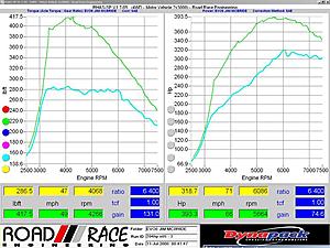

I gained 75 whp and 132 ft lbs going from 91 to E85. My parts selection was all made with maximizing torque as my primary focus. E85 really woke up my VIII. You will be extremely pleased with the results.
Here is my 91 tune (21psi) overlaid with the E85 tune (28psi).
