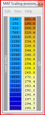

Hmm, I do have an injen intake with k&n filter. Maybe this is why I could not use this traditional method(as I mentioned above) to get my FTs right. I had about 30 combinations to try and get my FTs right, most all of which I didn't document.
Tephra, I'll make the changes you mentioned (unless you agree about the MAF scaling), then post my results. Mplspilot, I posted my current MAF scaling- maybe I could get another .02 from ya about what I can try from ya once we see the results of adding a little latency.

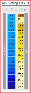

Give a try to what i suggested. Set the scaling at 860, set 14v at ~.750-760 and other voltages accordingly. Search for "how-to rescale MAF" thread in ECUFlash subforum. Rescale your maf and depending on your idle trim % increase 35hz and 50hz lines as described in the original "Rescale your MAF" thread.
Also when you will be adjusting your MAF scaling, don't wait 20min at a time. Disable your closed loop (put 222 in your "Min Temp for closed loop" table, clear CEL later). Adjust MAF units, start the car and watch the AFR. You want the AFR to be 14.7, so if it's leaner or richer, adjust MAF accordingly, reflash. Rinse, repeat.

Well, I followed what you said above and got my car idling at around 14.5 AFR in closed loop. I attached my MAF scaling table, should I be changing other values to smooth what I changed? Here is my current latencies/scaling:
3.624
1.992
1.344
0.984
0.744
0.576
0.456
860 scaling
Cruise FT = -6.9
Idle FT = 5.59
Should my idle FT still be 5.59, even though I got it at around 14.5? Should I keep adding 25 and 50Hz until my idle FT's zero?

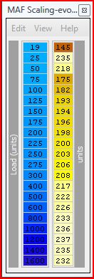

Ideally, would I smooth this entire maf table from 19-1600 or just adjust idle like I did? 145->235 is pretty drastic. Also why would I need to scale these 1000cc injectors so high, compared to most people?

Go up one more on the injector scaling and increase all the latency values by 0.020.

You can smooth those out on the bottom. I don't recall what i have exactly, something like this (from the bottom):
175
190
190
185
182
and stock values thereafter.
You can adjust cruising trims at corresponding Hz too using this method (~140-200), if you ever wanted..
Also it's nice to have the trims in check, but what about your main problem with going lean? I'd focus on that. Once you fix that you may need to revise your scaling/lat/maf etc.
