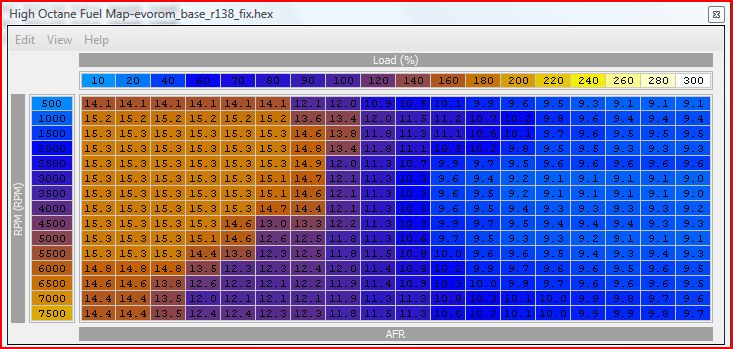

I've been confused trying to scale my injectors, and pretty much have to have something weird going on. I should have been able to do e85 perfectly fine with my pump and injectors, but I just had no fuel flow. My wide band sensor is <1000 miles and was just calibrated. I've attached my fuel map, which has remained relatively the same.

What's your warm idle? 14.7 or not? And why is the cold idle 16? On purpose or it's not tuned?
Your scaling for E85 was wrong. It needs to be 609 or under.
But if you keep going lean with rpm with your latest settings it may be a filter problem..

Once warm, yes it was 14.7ish and it's 16 cold idle because of my troubles tuning. I have scaled my injectors back as low as 500. It runs very rich, but still runs out of fuel at higher rpms under load.

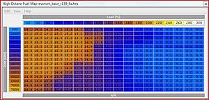

Cruise FTs are still way off. Driving without boost my afrs are nice around 14.7, but as soon as I put load on (even a couple lbs) I start running rich sometimes in the 10-11's. Up top I still run a little lean tho, like 13.5 at worst.
Sorry for getting a bit off topic going back to pump gas here, but I would like to see how I can get my tune again with 93 to see if I do in fact have a delivery issue.
I attached my fuel map as well, as I'm open for pointers. I think I have some work to do. Thanks for the pointer tephra!

The idle trim is still more positive than your cruise trim.
So try increasing the 11v and 14v just one more little bit.
Once we get the Cruise+Idle fixed then you can tune your fuel map.

The method of bringing idle trims close to cruise trims with latencies and then adjusting scaling to move them together to 0 as described earlier is a good idea that makes sense. In theory. In practice it does not work for everyone because a lot of people run aftermarket intakes that mess up MAF readings at slow airflow at idle. In those cases it's been my experience that the best way to adjust idle trim is to add fuel with MAF scaling table at low airflow..
And once you've decided on injector scaling, tune latencies for cruise trim.. I would think ~ .750 is whereabouts your 14v needs to be...looking at your results here...
