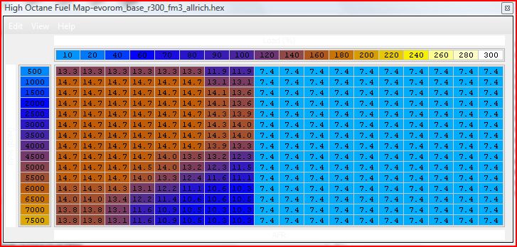

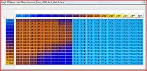

Well I did a few WOT pulls and I'm still lean up top. I am around 12-12.5 from around 5k up. I posted 2 screen shots of 2 different maps I tried, one of them I set all the cells from 100 load+ to 7.4.
Strangely my AFRs were about the same when I pulled in 3rd or 4th gear between the two maps. I expected it to go rich when I would floor it at lower rpms, but that didn't even change too much - only slightly richer.
Attached Thumbnails After E85 fill, running leaner and leaner.-rich.jpg   After E85 fill, running leaner and leaner.-same.jpg
Old Dec 17, 2008 | 02:21 PM
  #39
mrfred's Avatar
iTrader: (50)
Posts: 9,675
Likes: 132
Is this for gasoline or E85?
93 gas, e85 hasn't been in there for a few tanks.
Old Dec 17, 2008 | 03:10 PM
  #41
mrfred's Avatar
iTrader: (50)
Posts: 9,675
Likes: 132
I think you have a good case now for a failing fuel pump or clogged fuel filter. Just out of curiosity, what are the outside temperatures when your're logging?
