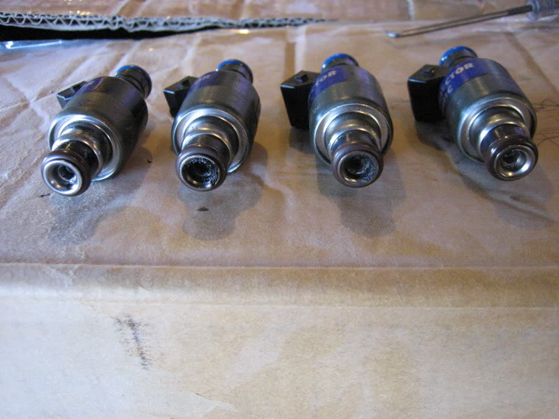

I found the "gunk" on some of my injectors today. These have about 2k miles on them. They are FIC 1150's. Also I am using e85 compliant fuel line, fuel rail, and FPR on this setup.

Dip them in pump gasoline and see if it dissolves and how quickly. Let us know.

I already cleaned it off with a q-tip and some acetone. If it happens again I can try it... but I hope that's not the case!

Wow, that is pretty unbelievable. I have to take off my Precision 1200s and take a look. I never heard problems with the ball and seat injectors and E85. Good thread, a heads up to Ethanol users everywhere. The thing that is interesting is it appears that two of those injectors appear clean, the other two look gunked up. Do you remember which spots on the intake manifold they came from, would be interesting to see what the inside of the fuel rail looks like...
I too thought E85 ran cleaner than conventional gasoline, it is pretty obvious from the cylinder and spark plug comparison from an Ethanol engine and a normal Gasoline engine, way cleaner. To me it seems like either rubber fuel lines or fuel pump housing gunk found its way to the tip of the injector and caked up. Just my two cents. B.S. in Organic Chemistry, 1 year into my Masters...

I pulled my FIC 1050s after a year on E85 (only ran gasoline twice during the year), and mine came out spotless. If you do some more more reading in this thread, in EvoM, and on the internet, you'll find its not caused by any hardware.
