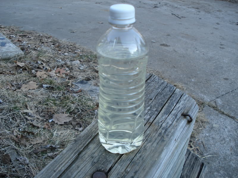

Here's a plastic bottle full of e-85 from Missouri. It's been in there since August '09. I wanted to see if this stuff was corrosive to plastic and it clearly looks ok. It's not clear. It has a yellowish tint to it. I poured some on the ground and the flame is really cool. There was no carbon deposits left on the concrete once it was done burning.
