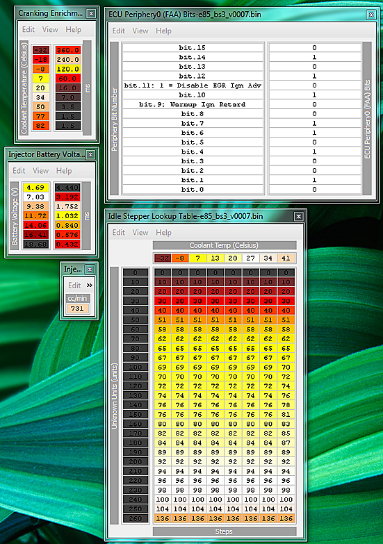

It was -5 degrees Fahrenheit in my part of Minnesota today and my car started great! I took a little video of the event for anybody who is interested. Nothing exciting just the car starting up and idling. But some solid proof you can basically run e85 all year if properly tuned.
Winter blend of e85 in our area is currently ~70% ethanol.
Mods:
2006 IX
FIC 1050cc injectors
Walbro 255
3" TBE
More setup information:
Car is using OEM sized battery
Currently using Denso IKH24 plugs gapped at .21
http://www.youtube.com/watch?v=qcgejK5IDs0
Below are my settings from EcuFlash that I believe are related to this success.
Enjoy!

Would you mind posting a pic of your IPW adder table and the primer table.
Mine are posted here. See item #3. However, I'm in Tucson, where we think 45*F is cold.
I have updated the first post with a screen capture of some of my settings, I did not see a "primer table" in my map in EcuFlash but IPW table and some others are shown.
FWIW I have the cold start ignition retard completely disabled.
I will try and grab an evoscan log from the car today and update the first post with it...
