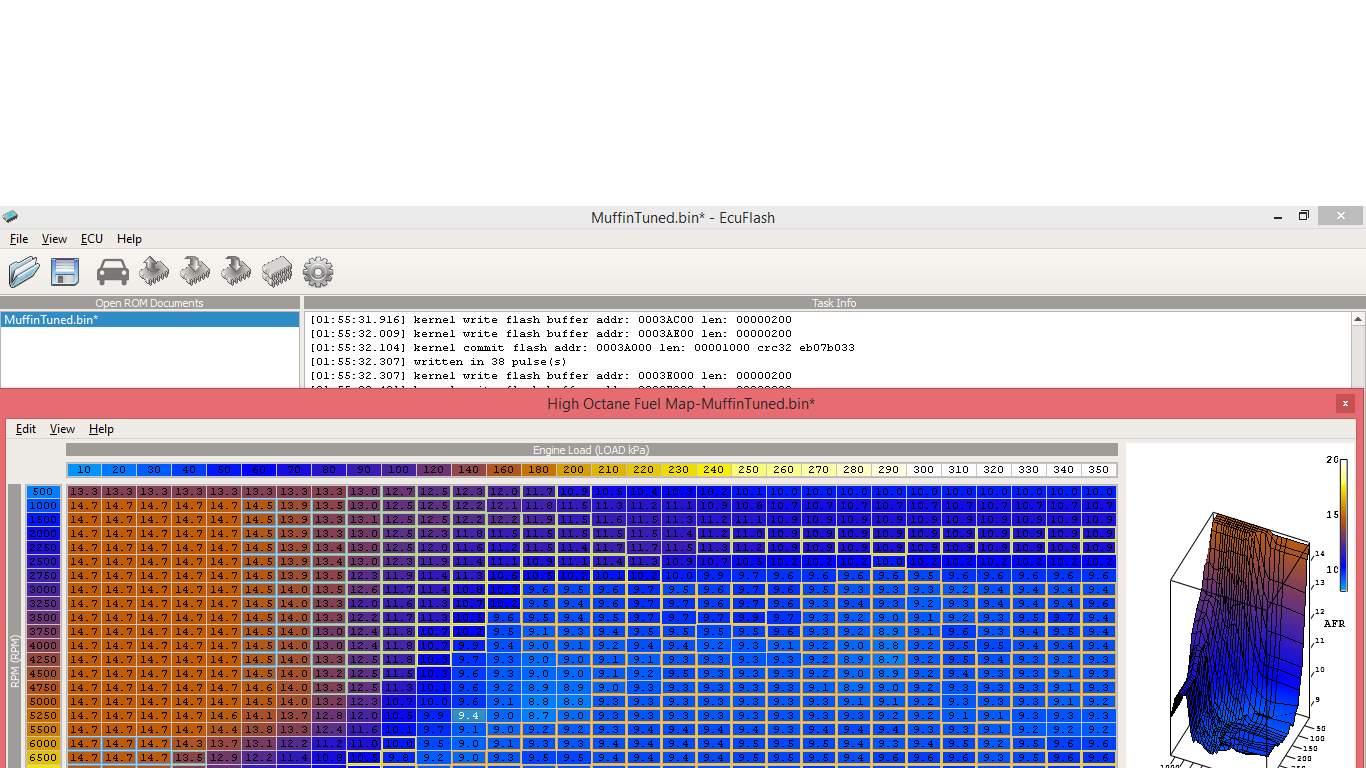

We haven't even touched timing tables yet. We did a good amount of work to the high octane fuel table and got the a/f's pretty smooth but before we could finish up, one of my heater hoses burst at the end of the pull shooting coolant on my windshield so we were done for the night.

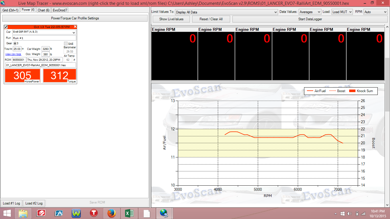

Timing advance is negative in the majority of the pull. I can't wait to start adding timing and seeing the gains. Virtual Dyno estimates 305whp/312 ft-lbs torque in Mustang dyno format with all the correct values put in as of right now. I'm not sure how accurate that is, but it feels about right. Boost spikes around 28-29 psi and slowly falls off throughout the powerband to around 24-25 psi.

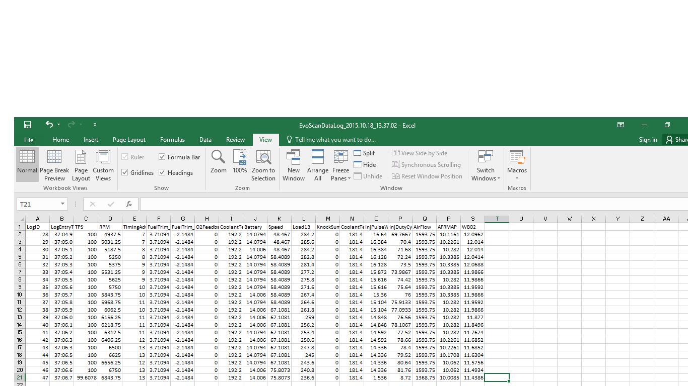

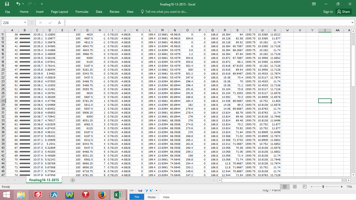

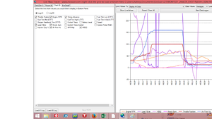

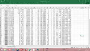

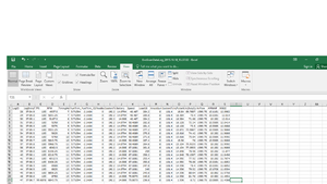

One weird thing I notice in all my logs that puzzles us both is that my 1byte load goes up to 288 at 3600rpm and then out of nowhere drops to 1.2 until 4900rpm, and then shoots back up to 304 and then drops off slightly throughout the pull. The slight drop off through the power band seems normal considering it is a stock Evo 8.5 turbo, but why the sudden drop off at 3600? Is there a reason that would happen? It's pretty concerning.
Also feel free to go over my logs and graphs and lend some advice, I appreciate any help. Thanks!

You need to raise your 2byte to 1 byte Load Factor. Your load isn't actually dropping but is just surpassing the limit of the default 1.2 load factor used in Tephra.
306 is the max that allows I believe.
255 x that load factor is how high you can log.
You must also change your formula in EvoScan to match the load factor used in Tephra for thw load logged to match the load used in your maps.

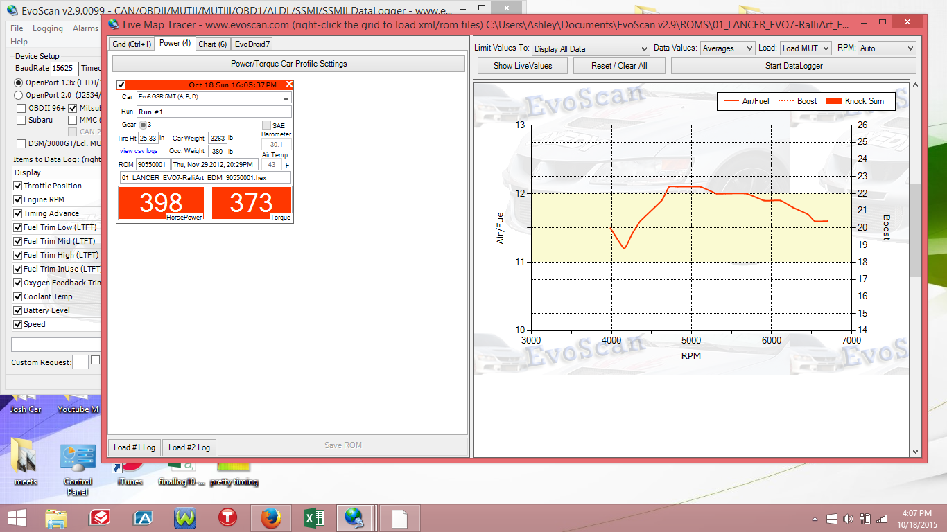

I included my logs/graphs from this morning. Also included a screenshot at my timing and fuel maps if anyone wants to take a look at those. Lean spool is NOT disabled, not sure that would have anything to do with my problems nor do I know what it does lol.

Turned off lean spool, retuned, Got the af's in line with some street tuning....or so I thought!
I wanted to do my timing on a dyno so I rented an hour of dyno time on a local shops Mustang Dyno tonight.
Well to my dismay I found out that my air fuels are almost a full point richer than what the dyno's wideband was reading. So rather than 11.9's- 12.1's, my af's were actually at 12.6-12.8. Due to that my entire hour that was suppose to be used for timing advance was used to get my air fuels in check on a wideband that actually reads correctly. I guess that explains why my logs showed inconsistant AF's with my NGK AFX logging. I copied a formula to use in evoscan someone else used with their AFX but perhaps it was the wrong formula. Some pulls the car still shows 3 degrees of knock, other pulls I don't get a single count. It's odd.
I had no time to really touch the timing map.
I'm running 3* at peak load and 18* by redline.
Unfortunately I'm going to have to rent the dyno again to dial that in.
My last pull of the night netted 345whp/355tq which is a bit lower than I was expecting but it is a Mustang dyno after all.

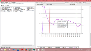

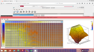

Here's a timing map that I have been working on. I added dots to the cells to display my load curve. White dots are spoolup. Green dots start at peak Load.
Keep in mind I haven't flashed this to my car yet. I'm running 18* of peak timing at my current timing map though. I do not rev past 7k. Actually usually never past 6500.
I need to get some more dyno time scheduled because I do not trust virtual dyno, it is too inconsistent.
After pasting this screenshot in MS paint I realized the large in my 5500rpm/ 280 load cell from the previous cell, so I brought that 5500/280 down to 12 degrees.
