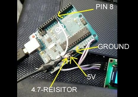

i did as well on it. the resister placement is key. has to be exactly like it is in the photo. i will try to post a photo of mine tomorrow.

I'm assuming this this ur setup found it on youtube, So from the looks of it where 5V is on the ARDUINO you put the 4.7 RESISTOR directly in the 5v pin on the ARDUINO and then tapped ur wires in it right after the RESISTOR for pin 8,, more close to the arduino,,,
