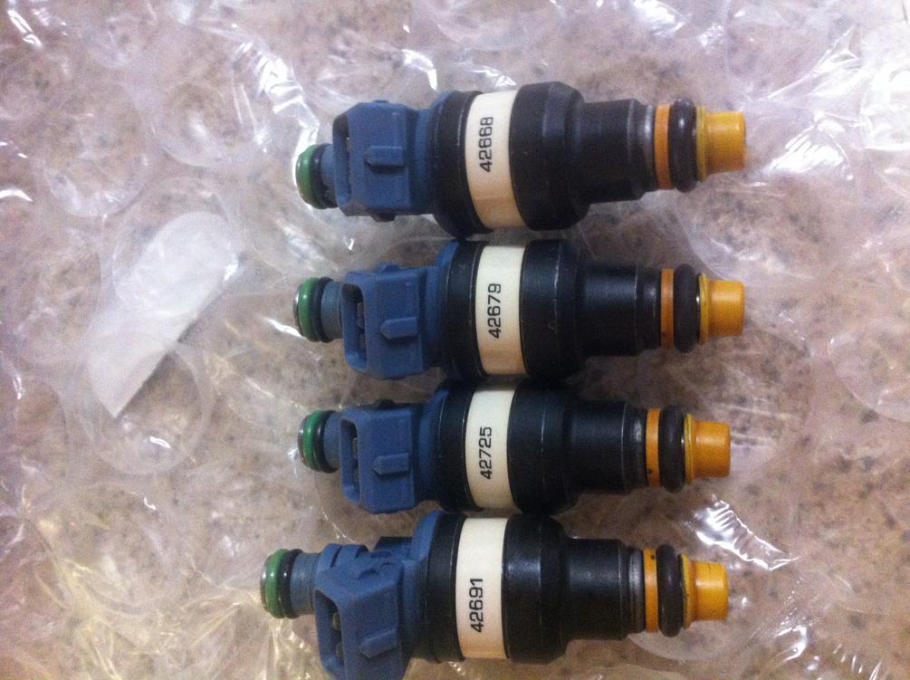

Pte 1600cc. Need latency!!! Help help
[QUOTE=Howulikemyevo;10677713]Anyone have latency for precision 1600cc injectors? I just bought these injectors but no latency on these injectors. My tuner told me to get the latency but i just dont know how to get it. Can someone please help??????
Attached Thumbnails Injector scaling and latecy for different injectors.-image.jpg
I suggest you find a new tuner. If he cannot scale injectors then he obviously has no business tuning Evos period.
