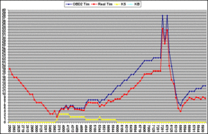

I am still running the Xede. Here are the two logs in excel charts. The first one has the KS and the Knock buffer (voltage multiplied by 10 to show it on the graph so the 19.1 spike is actually 1.91 volt spike).
Notice that in both charts the knock event does not reappear in 4th gear when the car hits the same rpm as in 3rd gear.
Also, the "real tim" is the actual tim since I am running an Xede. The Xede traces the OBD2 tim pretty well, albeit, at lower timing. The Xede timing usually peaks at 18 by redline.

They are both the real log. Hehehe.
Was the car up to temperature? Even if the coolant/oil temp gauges are at temp
the car sometimes wont run consistently until its been brought up to temp using WOT hehe. I guess the turbo needs to get nice and hot or something.
One way to address this problem is to do runs till you get some sort of
consistency. So do a third, then a fourth, etc and see if the logs settle down.
This isn't always feasible. And even if it works its still not optimal for street driving.
The actual reason why the car doesn't run the same from pull to pull is not well understood as far as I know, other than the temperature issue. I see the same sort of thing on my car so if you solve this problem let me know.
In my case using 100 octane gas on my 91 tune for the most part eliminates this sort of consistency issue. This suggests that those knock counts are real and that detuning the car for 91 will achieve a more consistent tune. This is what I did and it works to some extent.

I did four logs tonight. The first log had a knock event similar to the first chart/log I originally posted. The next three had isolated KS of 1-2 that were no where near the first log.
It is safe to say, that at least on my car, the first log is not to be used to tune the car. I think the car was not really warmed up as someone on here indicated.
In one log I did a 3rd/4th gear pull all the way to redline in both gears. There was just 1-2 KS here and there. I will post the chart once I make it.

Actually, if you are consistently seeing that spike on your first WOT pull, then I would do one of two things:
1.) detune your car slightly in that range, because during regular street driving this will be one of the more common scenarios (i.e. putzing along, engine not 100% up to temp and then ... WOT!)
2.) refrain from going WOT unless you know for sure the car is 100% warmed up.
Personally, I'd have to go for (1) ... better safe than sorry, and I don't think it will take much of an adjustment to iron out your 5500 to 6000 RPM range.
