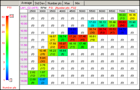

I am not Evo Kid, but I do have the data. The table shows the AVERAGE boost by rpm/afr for 6 3rd gear WOT runs. You can clearly see the taper. This is for a stock car with a TBE. There is no boost controller at all.

Thanks for the data. What I'm interested in particularly is the taper when the turbo is maxxed out - ie can you get x PSI more at 7000 RPM on an 8 vs a 9? Is anyone holding over 21 PSI at 7000 RPM on stock actuator on an 8?
If Evo kid's point about the MIVEC is correct, then the higher VE from the MIVEC engine is like the turbo blowing into a bigger engine than the 8, so it is not surprising that the exhaust manifold pressure blows open the wastegate at a lower boost level.

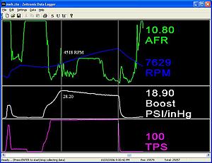

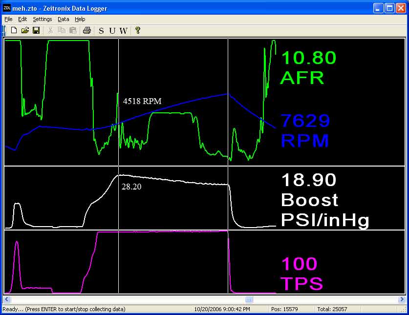

Here are some more numbers for an IX.
Oh and ignore the afr....
