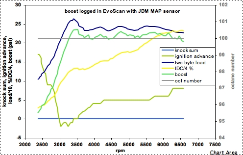

Finally got my JDM MAP sensor working with EvoScan and have solid proof that the majority of the boost taper can be eliminated with proper wastegate control. Yes, the boost is a bit wavy, but there is no taper out to 6500 rpm. There's going to be a bit of taper by 7000 rpm, but probably no more than 1-2 psi, and I can eliminate that if I want.

I'm impressed by your flat 220 load out to 7k rpms. In 3rd gear and high boost my load tapers TO 200 load by 7krpms (from 260 or more). Can you hold the load flat at say 260 load in 3rd gear?

that graph don't do nothing. I mean you cut the run off right when the turbo tapers anyways. Try holding that amount about of boost to 7600rpms.

I don't go out to 7600 rpm. My car signs off at 7000 rpm. Here is another log that I took this morning that goes out a bit past 7000 rpm. Yes, there is a bit of taper out past 6000 rpm. That is done purposefully by me. I have the waste gate duty cycle pulled back a little bit because the motor can't tolerate any more boost out there without knocking.

looking at your plots, you took the injector duty cycle and divided it by 4 to fit the scale correct? if so, your running 100% duty cycle at 6500rpm and up.... what do your A/F ratios look like? that may be why you can't tolerate any more boost at the higher RPMs... just not enough fuel flow up there.

Yeah, you noticed the duty cycle. I don't have a wideband installed, so I couldn't say if its going lean, but its a possibility. There is some debate as to whether 100% IDC as measured from EvoScan/Mitsulogger data really is 100% IDC. Some people report routinely exceeding 100% without going lean. Might be just tuned a bit lean too. Shiv is known for tuning on the lean side. Another possibility is that I'm choking the motor with my essentially stock exhaust system (with the exception of the Random Tech HFC).
