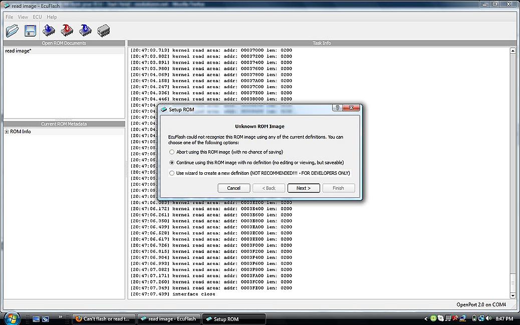

Old Jan 2, 2011 | 06:15 PM
  #895
PAdutch's Avatar
Joined: Dec 2009
Posts: 257
From: kunkletown/Easton, pa
Uknown rom image
okay, I got my ROM to upload but now I am getting a "unknown ROM image" message. I am guessing this is because it has a tune on it already. Not sure what to do now. I attached a pic of the error message. I also saved the log if that helps.

Old Jan 3, 2011 | 12:05 AM
  #896
And's Avatar
And
Joined: Dec 2005
Posts: 419
From: Bristol, England
did you save the rom image? if so look in the ROM section you can see in the left section and it'll tell you the ID then you just need the right xml file
Old Jan 3, 2011 | 12:14 AM
  #897
tscompusa2's Avatar
iTrader: (22)
Joined: Oct 2005
Posts: 5,375
Likes: 10
From: pa
that error is because you dont have the xml file.
Old Jan 3, 2011 | 12:16 AM
  #898
tscompusa2's Avatar
iTrader: (22)
Joined: Oct 2005
Posts: 5,375
Likes: 10
From: pa
lol my bad. you already said it.
put xml in here: Program Files\OpenECU\EcuFlash\rommetadata\mitsubishi\evo

Old Jan 3, 2011 | 12:25 AM
  #899
Peter10654's Avatar
Joined: Jul 2005
Posts: 138
From: Germany
You need your definition file for your rom.... This XML must be copied in your "OpenEcu" directory.... After this you can see all your necessary details from you rom.
You need to read more about this buddy.... x-times talked about in this forum. You can use "GOLDEN" def files.

Old Jan 3, 2011 | 06:39 PM
  #900
PAdutch's Avatar
Joined: Dec 2009
Posts: 257
Well Thanks for the help guys. I figured it out, apparently my car has the tephra mod v7 flashed so now I have a ton of reading and logging to do.
