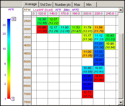

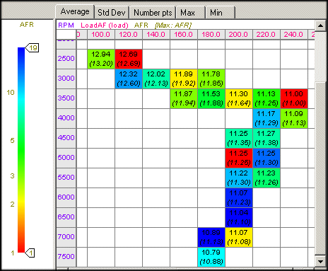

I posted my logs...seeing the same loads at the same RPM's but showing different AF ratios. I'm not so sure your idea will work.
I think it's really a function issue in evoscan at this point.

Yeah my car has/had the same problem with getting a stable AFR as a function of gear.
I never really found a solution for it....I think all the evos suffer from this.
One thing I did was to back off the timing so that even if it had a lean excursion I wasn't getting the bad knock.
If your unstable AFRs worry you because you like good data thats one thing. If they worry you because when they go rich/lean your power disappears thats another. In the latter case I would just suggest detuning the car so that its power delivery is more robust to AFR unstability and call it a day. Either that or run 100 octane...that makes the AFR instability a moot point haha.
I tried both the above solutions btw and they both worked.

I have my lean spool code essentially diabled. I also have most of my load cells above 200 atabout the same value. My AFR's are within a few tenths at full load every gear.
Another option is feedback using the wideband. If you jump onto the MAFT gen 2 ship you can install is such that the unit will fight to obtain a certian AFR that the user sets. I have one sitting in front of me as I'll be using it on my 1g eclipse.
Back on topic. I tried this today. Two runs in 3rd gear and two runs in 4th gear. My AFR was about half a point richer in 4th than in 3rd gear. The problem I having is if lean the AFR in 3rd gear beyond 11-11.2:1 I am getting more than 3 counts of KS. I would need to set the AFR @ 11.5:1 in the upper RPM range in 3rd gear inorder to make the AFR 11:1 in 4th gear @ the same rpm range.
The best solution to this is to run 100 octane gas all the time or create two maps one for road courses that use 3rd gear and another for road courses that use 4th gear. I think I am going to go with the latter option.
3rd gear
4th gear
3rd gear
4th gear
