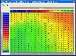

Naji, I run a little less timing than that for Shell 91 out here. I've attached a 3rd gear pull and my timing map. Car is completely stock, just the boost solenoid restrictor pill removed.
Attached Thumbnails What would cause a car to knock?-data_3rd.jpg   What would cause a car to knock?-ign_map.jpg
I think your on the right track with the low timing you are running. I hope you do not mind if I try your timing map on this Evo. I am not a big fan of advanced timing anyway.
