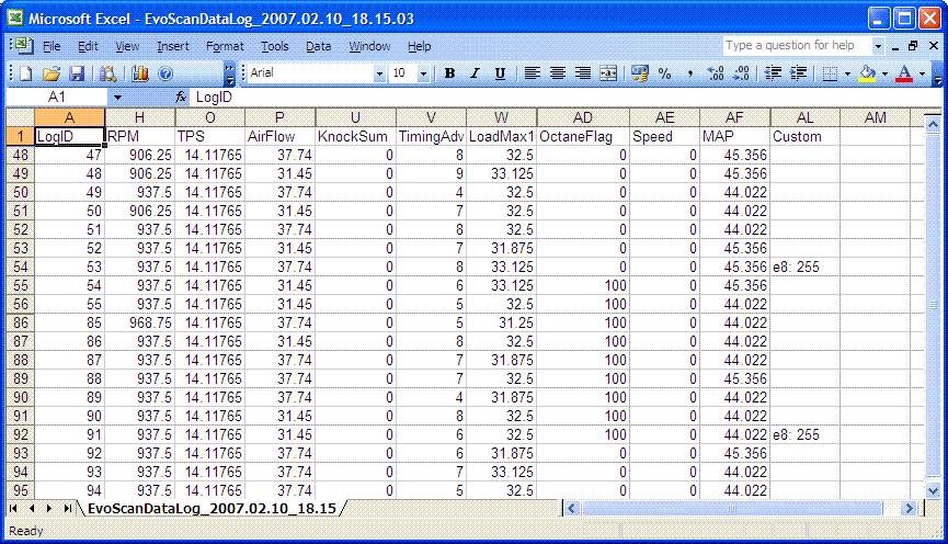

So I jump to my own routine at 37000 which I will post, along with Evoscan logs of it in action.
In this routine I check if the request ID is "E8" (which is unused).
If it is I XOR the octane value with 255. This toggles it between 0 and 100% - ie switches between the low and high octane fuel and timing maps.
So when the engine is running I can map switch.
I need to disable the increment/decrement octane value logic if I wanted to use this.
Usually with quite high knock sums the octane value doesn't move much, so this might be more useful for me switching between methanol and normal maps without reflashing each time.

You enter "E8" as a custom request at the bottom of the Evoscan window.
With JoeBee's little board you could do it with that too.
If we find the locations of some of the switched inputs you could do it with a combination of defog switch, intercooler spray switch etc.
The setting is remember until the ECU is reflashed or disconnected, or the battery is disconnected.
